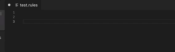

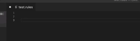

vsc
This was from build 1250.
And this is from build 1405.
vsc-broken
I dunno if removing this functionality was intentional or not…

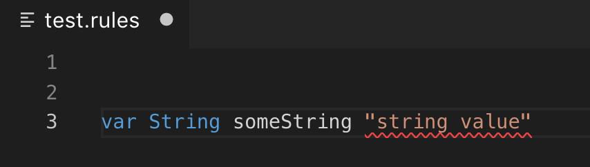

I’ve just quickly tested it on 2.4.0.M5 and VS Code 1.28.2 and it all works as expected:

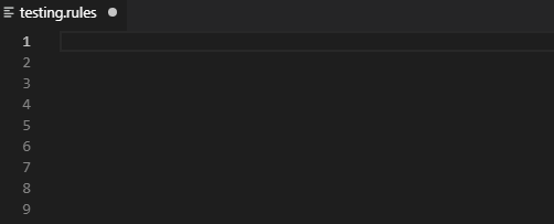

test
test1
