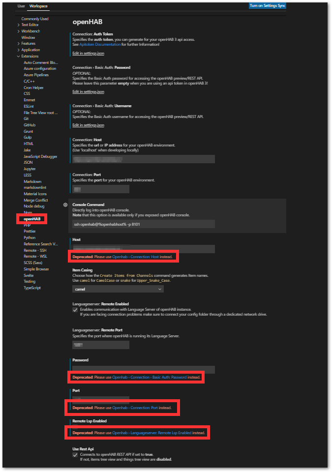

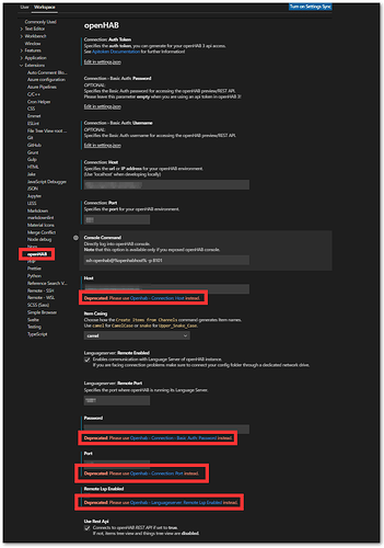

Complete refactoring of config parameters (This is breaking!)
Our extension is pretty old already and there where many changes on vscode side too.
I took the chance to refactor our config structure, which makes this a breaking change.
Thanks to the testing from @christoph_wempe and @ysc again.
I think we made the change as smooth as possible.
Several parameters have been moved or marked as deprecated.
I have introduced some logic to still use the old parameters.
This way the extension should work as known when you do the update.

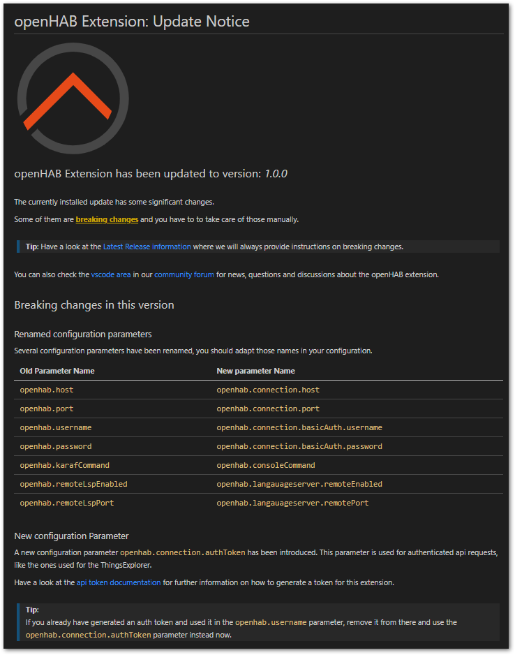

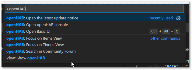

Add a proper Update Notification in the future
I think this is already missing for a longer time.
“Hey i have updated the extension now, but what changed?”
Hopefully this question will be answered better with this update screen in the future.
I have introduced it as it’s own page and i have some things in mind to change after this release,
so we can reuse it for new updates or even other informations in the future.

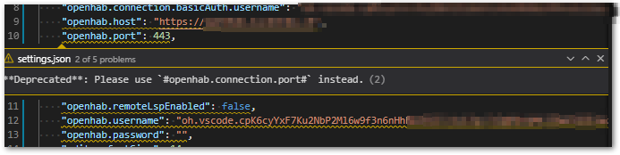

I have 1.0.0 installed now but it keeps complaining about karafCommand. please check again.
Usage of deprecated config => openhab.karafCommand <= detected.
