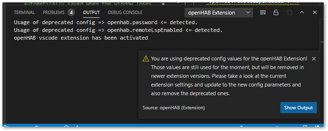

One thing to irritate was VSC kept complaining about deprecated parameters. There weren’t any in settings.json but turned out there’s also C:\Users<MyWinUser>.vscode\extensions\openhab.openhab-1.0.0-ci-5aaea7a\package.json` and it still had those old parameters. When I deleted them there the warning disappeared.
VSC was also spitting errors on the host it couldn’t connect to.
That package.json file also contained an old (now wrong) hostname parameter for the host to connect to and after replacing that the warning disappeared.
So thing is package.json seems to have precedence over settings.json ??

Could you please at least add an output which parameter this refers to ? I likely have one that I thought is current but the extension considers it to not be - just that I do notknow which one that is.
Gnah.
I had something like this built in already, but it just produces an output when a deprecated setting “is used by an extension part” but not when it is set at all.
That’s not how it was supposed to be, but it seems that it has anded up the wrong way in a refactoring.
I will put out a list of deprecated parameters in the openHAB extension Output.
Should we add a Button to the warning to open the output directly?

Thanks. Hmm, it says
Usage of deprecated config => openhab.consoleCommand <= detected
But isn’t that the correct, new name ? At least the settings page says so.
Do you have configured the consoleCommand on purpose?
How did you configure it, if the answer is yes? (User or workspace setting?)
Can you also check if you still have openhab.karafCommand configured somewhere maybe?
I will try to reproduce the behavior based on your config situation in my debugging environment then.
yes, user settings
It was indeed a small bug in the karaf parameter check.
