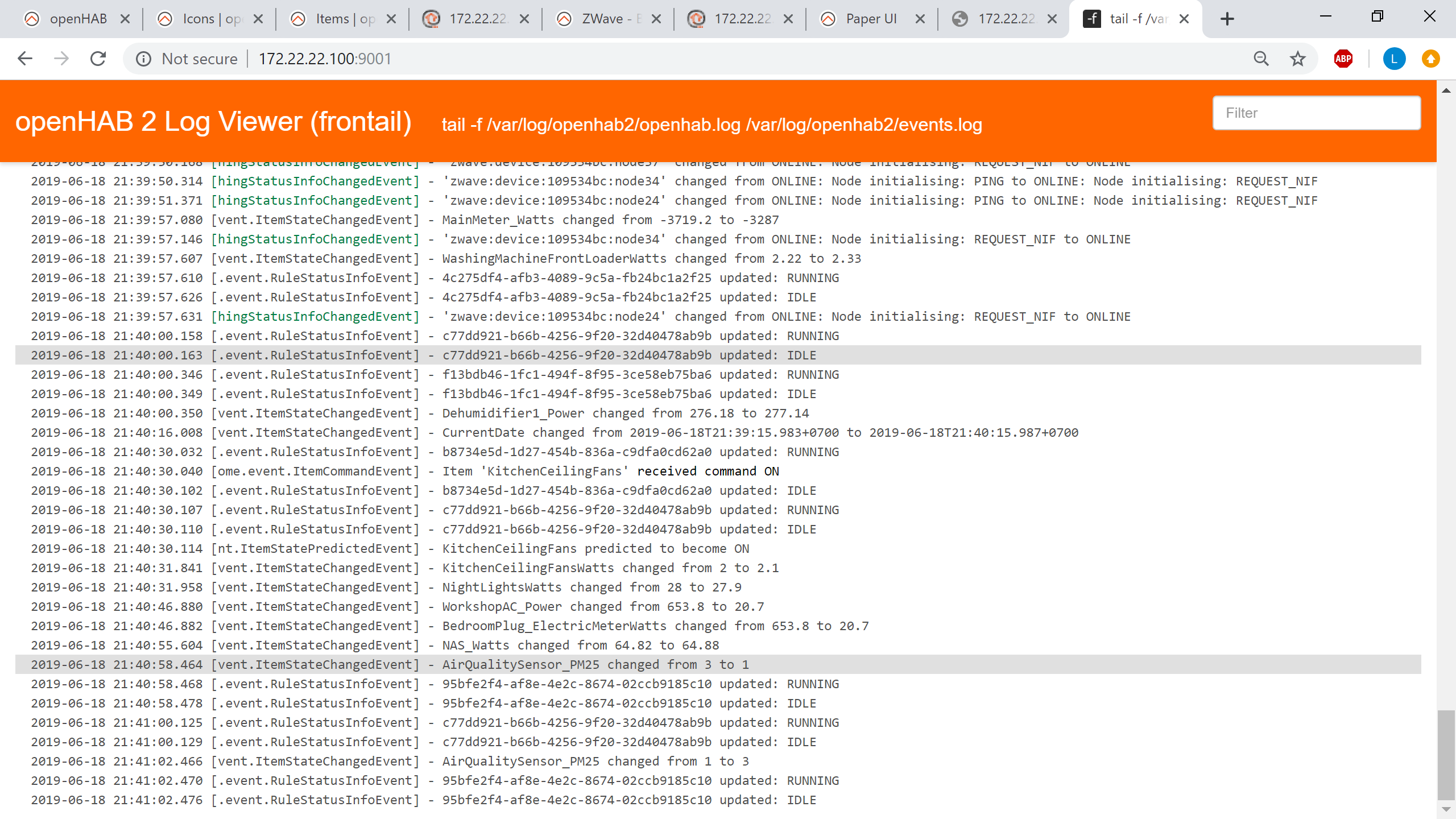

Or, can you suggest another way of turning an old (windows 10) tablet into a realtime openhab log viewer?
