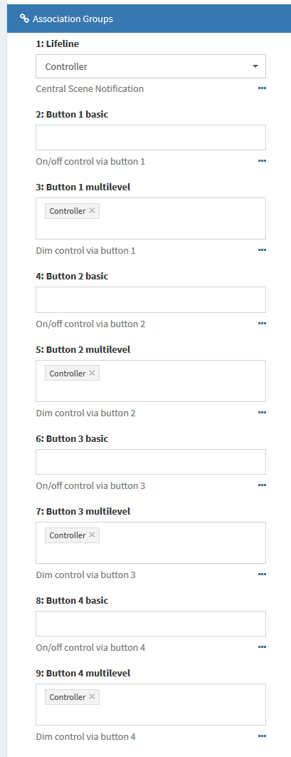

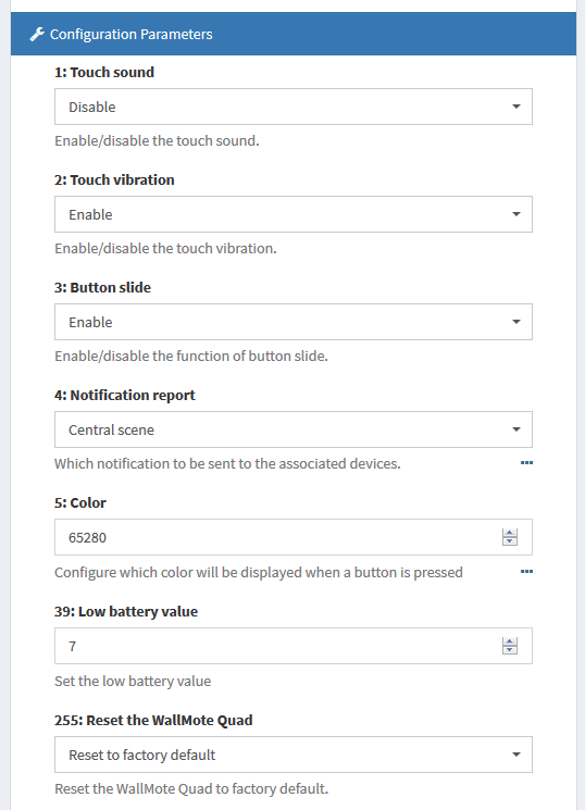

I have 6 x WallMote Quads and the only non-default settings that I needed to change for sliding events was “Button 1/2/3/4 Multilevel”. These should be set to “Controller”, as was mentioned earlier.
The “Notification Report” settings does not need to change from its default, “Central scene”.
Because these are battery-based devices, it can take a few attempts to get the configuration to store. I found it useful to toggle the “Touch Sound” setting to be certain the revised configuration was stored.
The channel for swipe events adopts the form zwave:device:abcdef:node123:switch_startstop1.

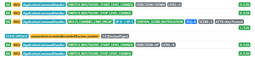

If I slide I can observe the following parts in the log
23-Okt-2020 16:19:05.431 [DEBUG] [ng.zwave.internal.protocol.ZWaveTransactionManager] - NODE 48: Checking command org.openhab.binding.zwave.internal.protocol.ZWaveCommandClassPayload@99f90b.
23-Okt-2020 16:19:09.516 [DEBUG] [ng.zwave.internal.protocol.ZWaveTransactionManager] - NODE 48: Application Command Request (ALIVE:DONE)
23-Okt-2020 16:19:09.518 [DEBUG] [.openhab.binding.zwave.internal.protocol.ZWaveNode] - NODE 48: resetResendCount initComplete=true isDead=false
23-Okt-2020 16:19:09.519 [DEBUG] [.openhab.binding.zwave.internal.protocol.ZWaveNode] - NODE 48: Incoming command class COMMAND_CLASS_SWITCH_MULTILEVEL, endpoint 0
23-Okt-2020 16:19:09.520 [DEBUG] [.openhab.binding.zwave.internal.protocol.ZWaveNode] - NODE 48: SECURITY not supported
23-Okt-2020 16:19:09.520 [DEBUG] [e.internal.protocol.commandclass.ZWaveCommandClass] - NODE 48: Received COMMAND_CLASS_SWITCH_MULTILEVEL V3 SWITCH_MULTILEVEL_START_LEVEL_CHANGE
23-Okt-2020 16:19:09.521 [DEBUG] [col.commandclass.ZWaveMultiLevelSwitchCommandClass] - NODE 48: Switch Multi Level start level change, direction = DECREASE
23-Okt-2020 16:19:09.522 [DEBUG] [rg.openhab.binding.zwave.handler.ZWaveThingHandler] - NODE 48: Got an event from Z-Wave network: ZWaveStartStopEvent
23-Okt-2020 16:19:09.523 [DEBUG] [rg.openhab.binding.zwave.handler.ZWaveThingHandler] - NODE 48: Got a value event from Z-Wave network, endpoint=0, command class=COMMAND_CLASS_SWITCH_MULTILEVEL, value=DECREASE
23-Okt-2020 16:19:09.525 [DEBUG] [ng.zwave.internal.protocol.ZWaveTransactionManager] - NODE 48: Commands processed 1.
23-Okt-2020 16:19:09.526 [DEBUG] [ng.zwave.internal.protocol.ZWaveTransactionManager] - NODE 48: Checking command org.openhab.binding.zwave.internal.protocol.ZWaveCommandClassPayload@191557f.
23-Okt-2020 16:19:09.530 [DEBUG] [ng.zwave.internal.protocol.ZWaveTransactionManager] - NODE 48: Application Command Request (ALIVE:DONE)
23-Okt-2020 16:19:09.530 [DEBUG] [.openhab.binding.zwave.internal.protocol.ZWaveNode] - NODE 48: resetResendCount initComplete=true isDead=false
23-Okt-2020 16:19:09.531 [DEBUG] [.openhab.binding.zwave.internal.protocol.ZWaveNode] - NODE 48: Incoming command class COMMAND_CLASS_SWITCH_MULTILEVEL, endpoint 0
23-Okt-2020 16:19:09.532 [DEBUG] [.openhab.binding.zwave.internal.protocol.ZWaveNode] - NODE 48: SECURITY not supported
23-Okt-2020 16:19:09.533 [DEBUG] [e.internal.protocol.commandclass.ZWaveCommandClass] - NODE 48: Received COMMAND_CLASS_SWITCH_MULTILEVEL V3 SWITCH_MULTILEVEL_STOP_LEVEL_CHANGE
23-Okt-2020 16:19:09.534 [DEBUG] [col.commandclass.ZWaveMultiLevelSwitchCommandClass] - NODE 48: Switch Multi Level stop level change
23-Okt-2020 16:19:09.535 [DEBUG] [rg.openhab.binding.zwave.handler.ZWaveThingHandler] - NODE 48: Got an event from Z-Wave network: ZWaveStartStopEvent
23-Okt-2020 16:19:09.536 [DEBUG] [rg.openhab.binding.zwave.handler.ZWaveThingHandler] - NODE 48: Got a value event from Z-Wave network, endpoint=0, command class=COMMAND_CLASS_SWITCH_MULTILEVEL, value=STOP
23-Okt-2020 16:19:09.537 [DEBUG] [ng.zwave.internal.protocol.ZWaveTransactionManager] - NODE 48: Commands processed 1.
23-Okt-2020 16:19:09.538 [DEBUG] [ng.zwave.internal.protocol.ZWaveTransactionManager] - NODE 48: Checking command org.openhab.binding.zwave.internal.protocol.ZWaveCommandClassPayload@92f27b.

I suggest trying the log viewing suggestion from @Bruce_Osborne to verify Z-Wave events are actually being sent by the WallMote to your controller when you tap a button.
Imho the events are correct

The commands are not being sent as the binding is expecting. The channels are configured to use the multi-channel encapsulation, which allows the binding to know what switch has been changed. This log shows the commands from the root endpoint and there is no channel associated with that command.
Hm - I guess they must have changed the device.
It is not possible to use the swipe functionality then.
It seems unlikely. Multichannel encapsulation is needed to differentiate the different switches on the device. Probably this is a configuration issue, or something was wrong when the device was initialisation and the incorrect associations were used.
The device will only send multichannel encapsulated commands if configured in a certain way. I’d probably suggest to reset the device and reconfigure it. If you supply a debug log I’ll take a look.

Set the config as described and swipe only in the quadrant (start and stop must start in the same quadrant).

Please, would you list what are the configs you’re using? Thx
Just scroll up :wink:
