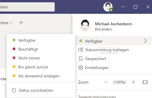

I’m looking for a way to use my Microsoft Teams presence status in OpenHAB to change the color of a fibaro plug led.
It’s time for home office and then the kids could see, when it’s possible to enter the office…
Is there any existing binding or way to get this status?

In Teams for web I can see this information in a browser.
But using the http-binding seems too complicated for me.
