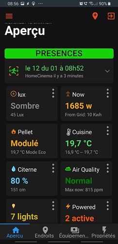

Washing machine status widget

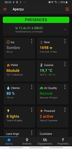

Same on android beta
I assume you installed this through the marketplace? Could you try to add this widget manually in the Dev Tools and see if it looks strange there as well?
same problem, in fact, all the design chnage between chrome and the android app is strange
chrome:
App android
obviously is not your widget :slight_smile:
Ok let me know if you find something related to my widget :+1:
You might want to consider opening another issue for your problem to find someone who is able to help.
yes, thanks !

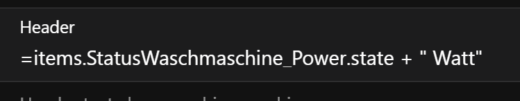

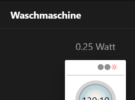

Can anybody help me with formatting a number?
gives me
I’d like to display integers, like ā€œ35 Wattā€. Can anybody help me formatting the header string?
Metadata / State description won’t help
Try state.split(ā€œ.ā€œ)[0] + ā€œ Wattā€œ
If you want to use the state description you need to use displayState instead of state.
THX! displayState worked perfectly.
Wonderful widget, by the way!

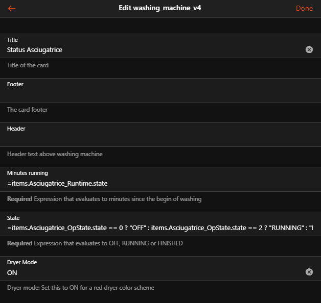

widgets seems to work perfectly but remaining time is not working, keep displaying NaaN:NaaN, but animations works.
widget config is this one:
what’s wrong?
You need to create an ECMA JavaScript rule and paste the code there. You created a DSL rule. This should fix your problems :+1:
OMG…crazy for this. ok i’ve changed it, i will check that everything else is okay.
thanks a lot for this hint!
i’ve set it to ECMAScript (ECMA - 262 Edition 5.1) and in log i have no more errors, but in the widget, i have the running minute counter that start from 0:00 and count till 0:04 and then reset to 0:00.
some other times, count till 0:01 and then back to 0:00 and other times, til 0:02 and back to 0:00.
any idea?
It might be that your configuration items need some fine tuning: what are your waittime and threshold parameters? It seems that your machine consumes less than the threshold for a short period and your waittime is even lower than this period.
