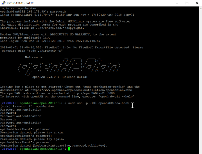

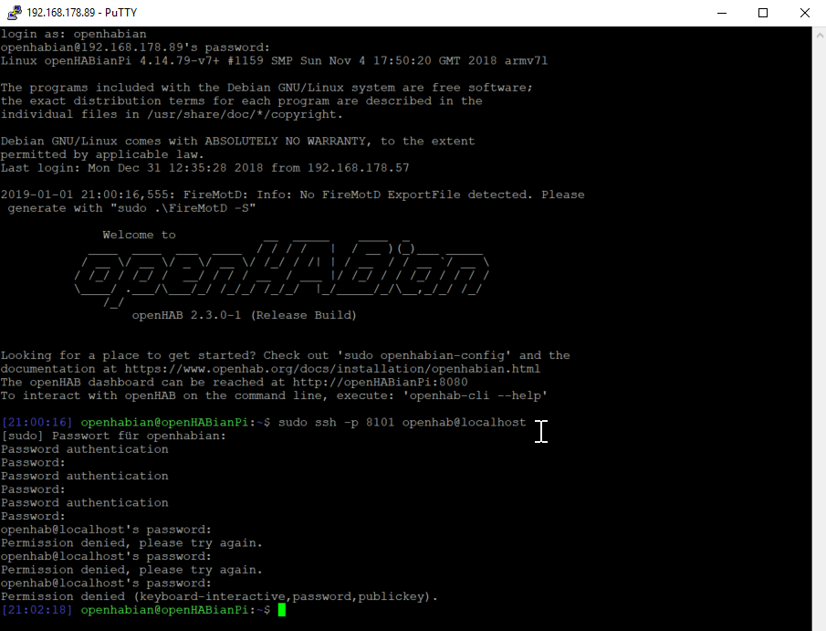

I already got problems with that, I cant figure out how to log into the console.
  1. the sudo password
  2. habopen as password right? Doesnt work
  3. the password for my local user, the password I use to log in into the SSH and the password thats the sudo password
what am I doing wrong?

This is strange, as far as I can see are you doing right.
I have seen some links about to login, regarding RaspberryPi, It may take a while to be logged in, in some times a couple of minutes.
Please, see also following,
User password needed for SSH or sudo (e.g. “openhabian:openhabian”)
Samba share password (e.g. “openhabian:openhabian”)
openHAB remote console (e.g. “openhab:habopen”)
Amanda backup password (no default, applied when installing)
Nginx reverse proxy login (no default, applied when installing) For manual configuration see here.
InfluxDB (No password set by default)
Grafana visualization (“admin:admin”)
This link is also about The Console.
I have just upgraded my openHAB to 2.4 so I will asap have a look at the latest OpenWeatherMap binding too.
2.4 works just great, I am running openHAB on Linux Mint 18.4 (I will remember) and there is an automated upgrade in this OS, so I used it for openhAB and it works, just have to reboot.
Best Regards Basse

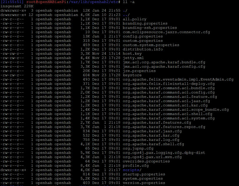

Hi Felix,
You can try to access the console via $OPENHAB_RUNTIME/bin/client command instead of using ssh.
Did you perhaps changed your password?
To reset the password edit the /var/lib/openhab2/etc/users.properties file manually by replacing the password or password hash (including {CRYPT}) with your new password in clear text (see section Changing the Password). By default, the line with the password contains the text openhab = , followed by the current password (e.g. habopen ) or a password hash (e.g. {CRYPT}4AE1A0FD...{CRYPT}).

Indeed I changed my password. However I only changed the openhab password. This is irrelevant for the console right? And I tried logging in into the console with the original “openhabian” and my changed password.
Moreover I can’t find that file
