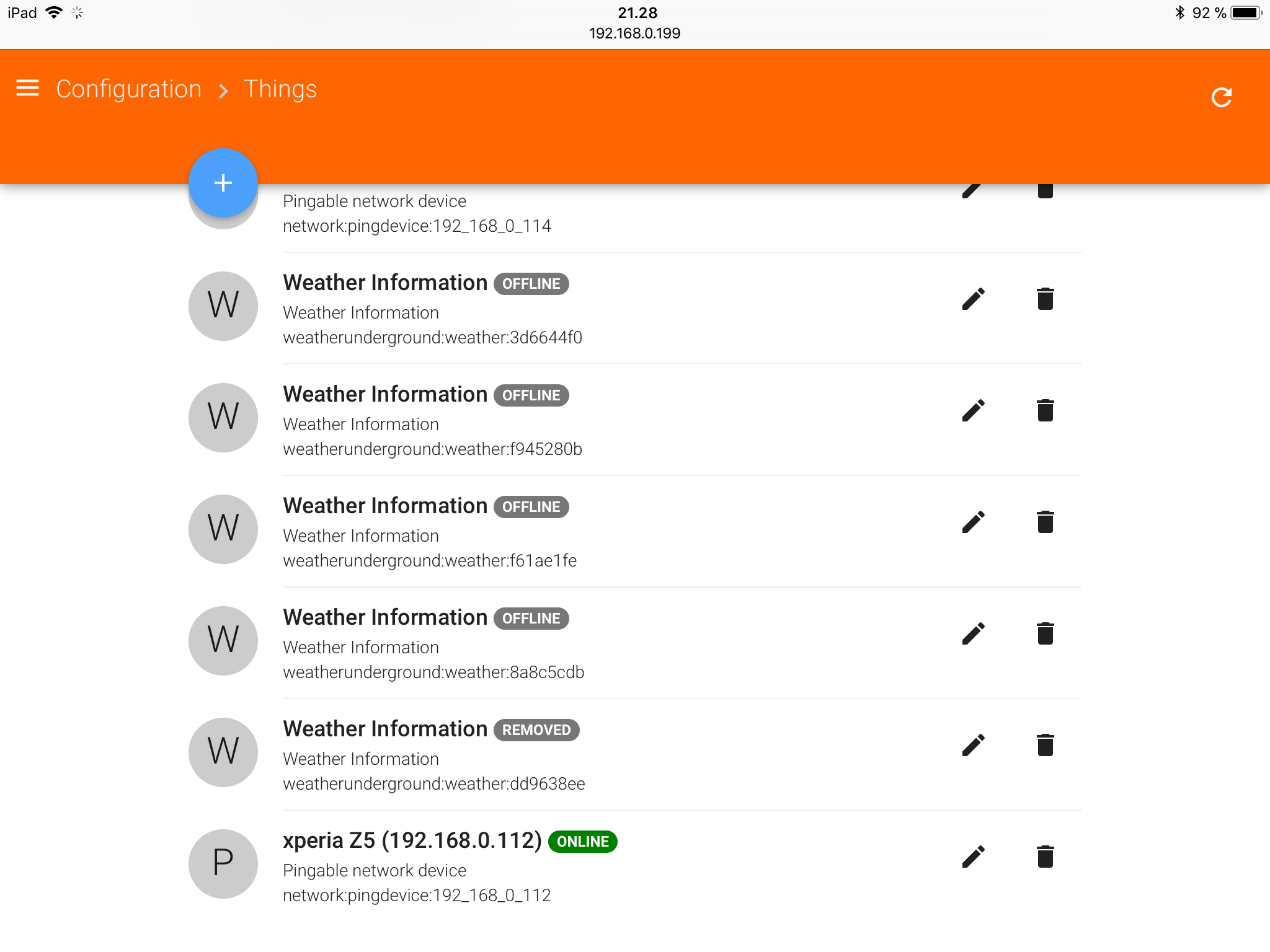

im kinda lost ..I’m having several offline bindings regarding weather. when i’m trying to delete i get an error 409.
409 refers to an internal error? how can that be, is there two places where one can fill in informations.. !!
i know there is, but why ? why isn’t the settings a general setting where every binding should get the needs from ?

cache cleared.. and i figured how to get rid of the error 409.
my “mistake” was apparently that i have been filling out the
Configuration >System> regional setting > location af installation
and like wise the settings location setting for the weather …
in my opinion it would be an massive improvement to have just one page of settings where all binding would get what’s needed for them to work..
