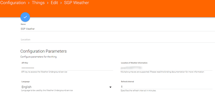

My OH server died forcing me to rebuild and reinstall from my backups. I have everything back in place with the exception of the Weather Underground binding displaying the temp in Celsius rather than Fahrenheit…I cant seem to remember where I made that choice…I’ve read the docs and I must be reading so hard I’ve missed it.
I set up the THING in Paper UI and there is no setting for units of measure in the dialog box.

Is true, but based upon my question and the screengrab I placed you can not define that part of the channel through PaperUI - correct?

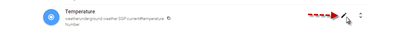

Yes of course you can setup this setting in Paper UI, just open the window that show your thing channels and you will see the setup icon on each channel that have a setting.
Thank You…
For those of you that have the issue, please see the image below
Click on the pencil icon to change between Celsius and Fahrenheit.
