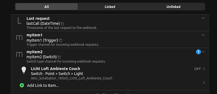

I can switch the light via the ui, no problem. And i see the state-change both in the sse-stream and the events.log
Using http://10.0.0.75:8080/webhook/CMD?myItem2=OFF in my browser just gives me a blank page
I previously used the example-code many posts above and there was no response too. Am i missing something? Do i have to install something else?
If your browser stays blank that is normal. Does your item AKU_Schaltaktor_… switches from OFF to ON if you send now the ON command?
Is your item connected to another thing-channel or just the webhook one?
The item (light) is linked to the the KNX-channel (group-address).
I can change the state of the light over the KNX-channel. The webhook does neither work on ON or OFF
Not sure if you can override a state when linked to KNX…
Just for testing purpose: could you create a seperate test item? Let’s try to get an easy and simple scenario which works and then you could step up and add more complexity.

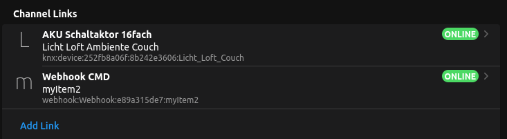

Ok. Here is the problem:
Your thing ID is not “CMD” but e89a315de7.
The URL for your http request is:
http://10.0.0.75:8080/webhook/e89a315de7?myItem2=OFF
Ohh! How stupid! I misinterpret “CMD” as a command-call :smiley:
Yes, now this works! Kind of!
The item is switched on and off, but the light does not switch.
But thats ok! Switching ligths was not my goal, i have to use a rule anyway. For now i am switching a dummy-item and use a rule to switch the light :smiley:
If your item is linked to knx binding, maybe this binding does not allow to change the state of that channel item. Is this item of type contact or switch? Did you set it to read-only?
Do you see anything in the log, e.g. that knx resets the value of the item after you have changed it via webhook?
i think there is a difference: the switch in the ui sends a command, the webhook just switches a state:
