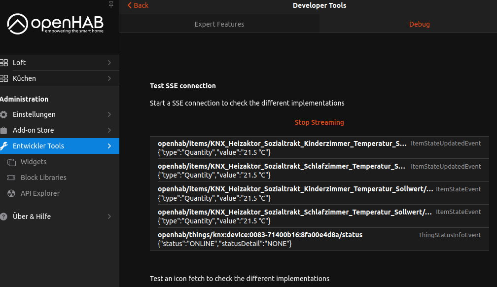

I still dont get any response from openhab. shouldn’t I see events in the eventlog?
I used the second example and linked it with a light, neither ON or OFF shows a response.
