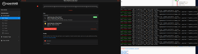

However, I faced difficulties when trying to realize the dimmer. According to stdout of zigbee2mqtt (which I am using in combination with mosquitto), the broker is receiving mqtt messages. Almost everything seems to be correct with the messages, except the number that I have injected to the string via %s. The “Outgoing Value Format” was set to {“update_available”:true,“state”:“ON”,“brightness”:250,“color_temp”:%s}. Later I figured, that the update_available was unneccessary :wink:

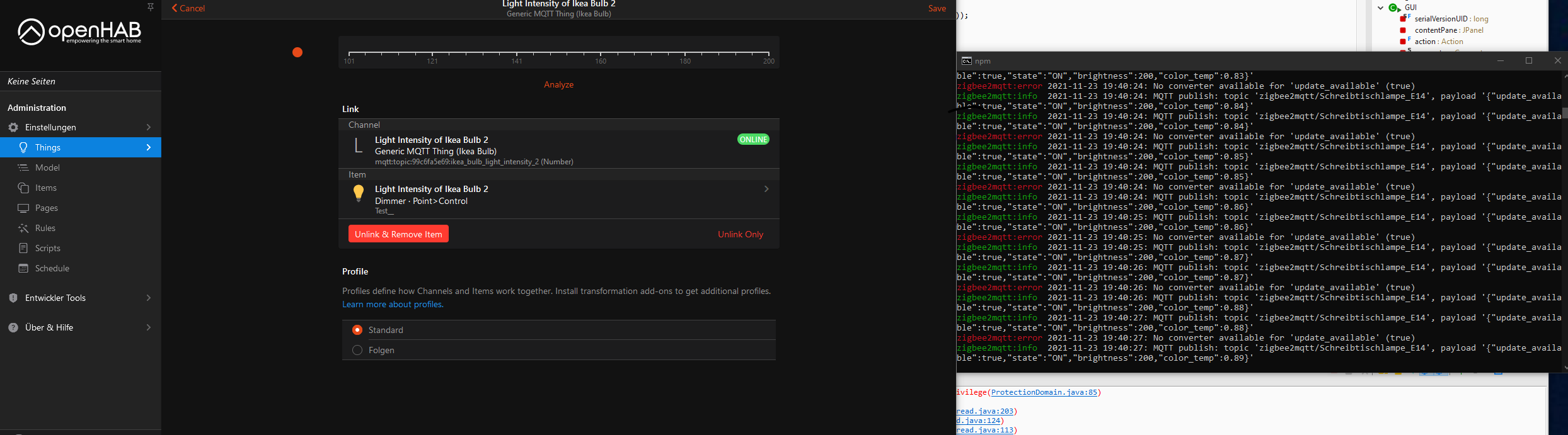

When I have prepared the dimmer from the range 0 to 100, however, the log did not show “color_temp”=61 but “color_temp”=0.61 instead. I thought, that this was some kind of additional calculation (divided by 100), but moving the min and max of the channel did not solve the issue. The behavior was the following: Whenever I pulled the handle to a number over 100, it did not send any messages anymore, but always jumped back to the previously set value below 100:
Does anyone know what could be the reason for this? I have tripple-checked the configurations and the code, but I did not find any obvious mistake from my side. Is there any solution for this? Or a workaround if this is actually a bug?

I don’t think you understood the thread I linked you to; the problem there was linking a Dimmer type Item to a number type channel. Try a matching dimmer channel type instead (which I think the GUI may still call ‘percent type’).
