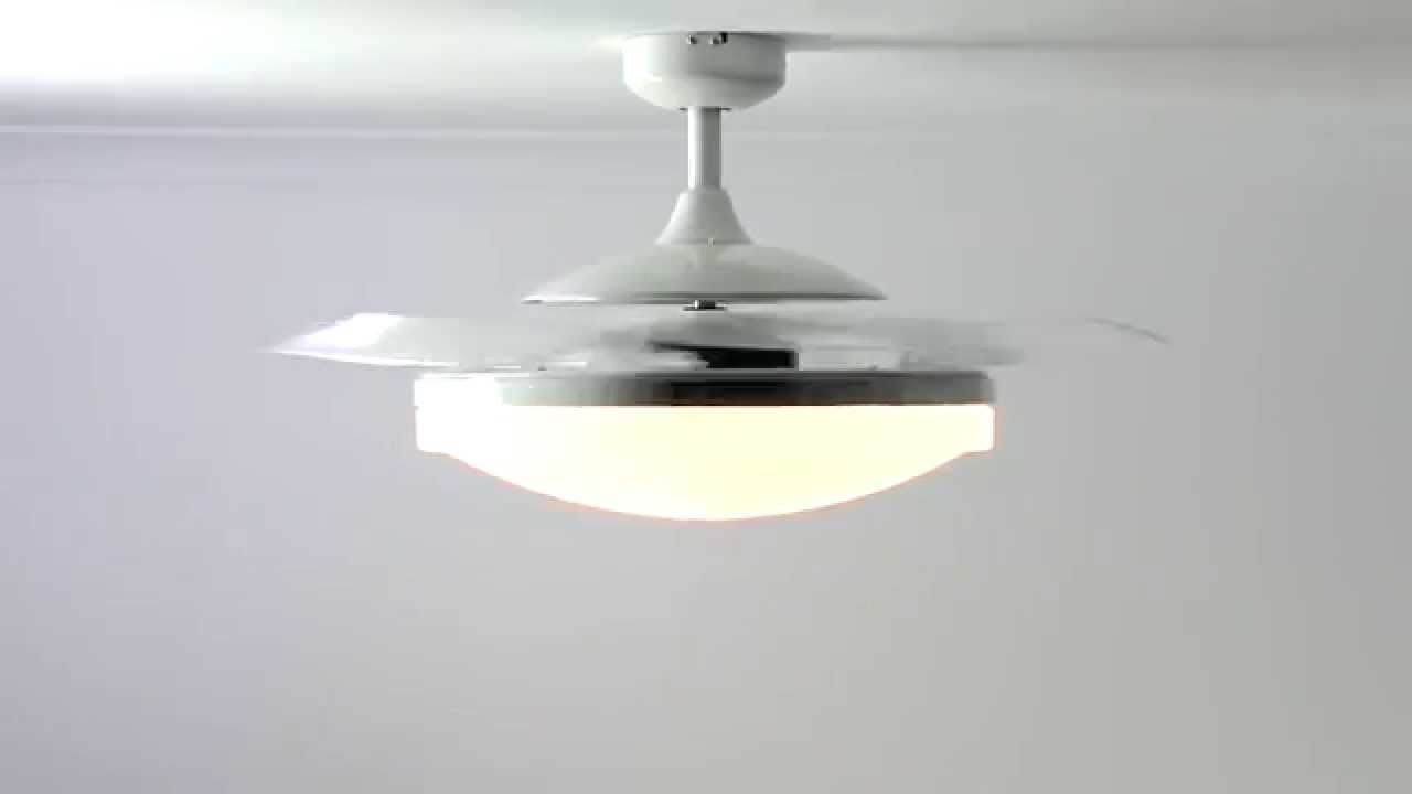

I bought the 132cm Version which is big.
But it does not stand out on the ceiling, because of its decent design.
I am using the Sonoff 433 MHz RF-Bridge (with Tasmota Firmware) to control it.
If you use another fan, you might need to read the RF commands for your model first.
But you will find the commands for this model in the config below.
Ofcause the RF-Bridge can only send commands to the fan and does not receive any status information.
But controlling it with via Amazon Alexa works great.
I can turn it on/off, change the speed and invert the direction.

Nice feature are the hidden blades and the big light. I replaced the original RF controller with a SONOFF iFan02, flashed with Tasmota.
This gives me full MQTT control over the light and fanspeed in openHAB.
