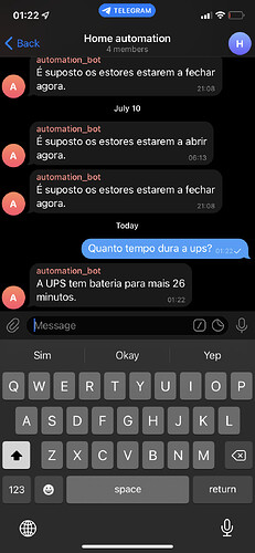

I can help :slight_smile: I have a very similar setup, I’m rocking an Eaton 850VA, also with NUT.
What I did was to create an automation with node red and a telegram bot.
So I can ask at any point the current duration of the battery. And if it falls down to under 300 seconds then it triggers a dialog (through telegram as well) which will lead to starting a save shutdown. This last
Part is not yet implemented though.
(Sorry about the Portuguese, usually I have everything in English. It’s a basic setup though. The first couple messages it’s a simple
Information stating when the blinds are opening/closing. Then I ask how long the UPS lasts, and it returns the actual value in minutes. Hope this explanation is good enough.)

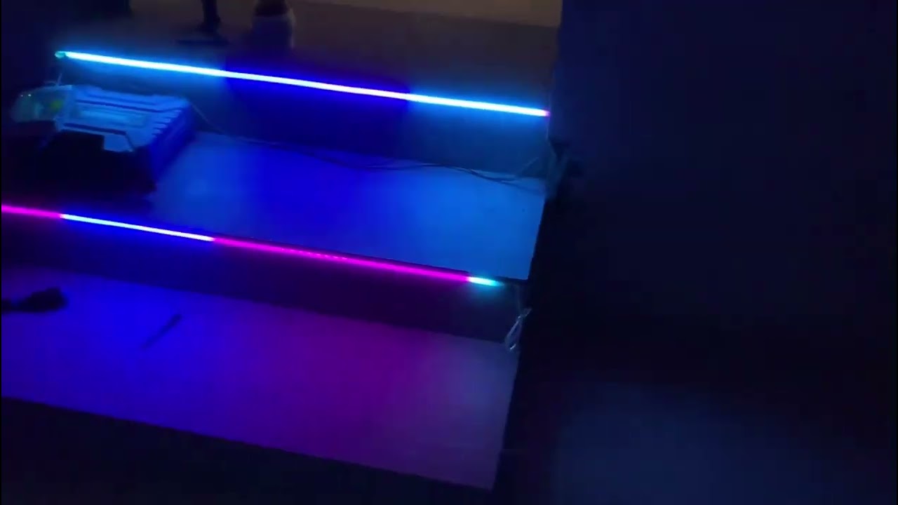

still not even 20% done… i have 20 stairs to wire up :face_with_peeking_eye:
Very cool. Are you controlling these with Arduino and WLED? Do you have a motion sensor that triggers and then Openhab sends the command?
Agree with the user above. We need more details!
ahh wanted to an orgnize post but i will tell
  1. for now i use an ESP8266(need to upgrade to a dig uno) and yes WLED
  2. still no conncted to my setup, i have planty of PIR around the house so i will use them as input
  3. acuutly i HA user now and not OH :frowning: but i like this fourm better :slight_smile:
This looks great! What LED strips are you using?
using WS8211 12V trying to keep the cost down…
ok so i could not wait enjoy

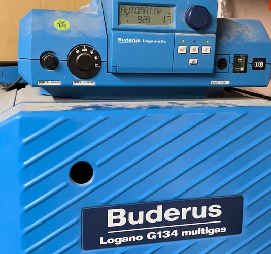

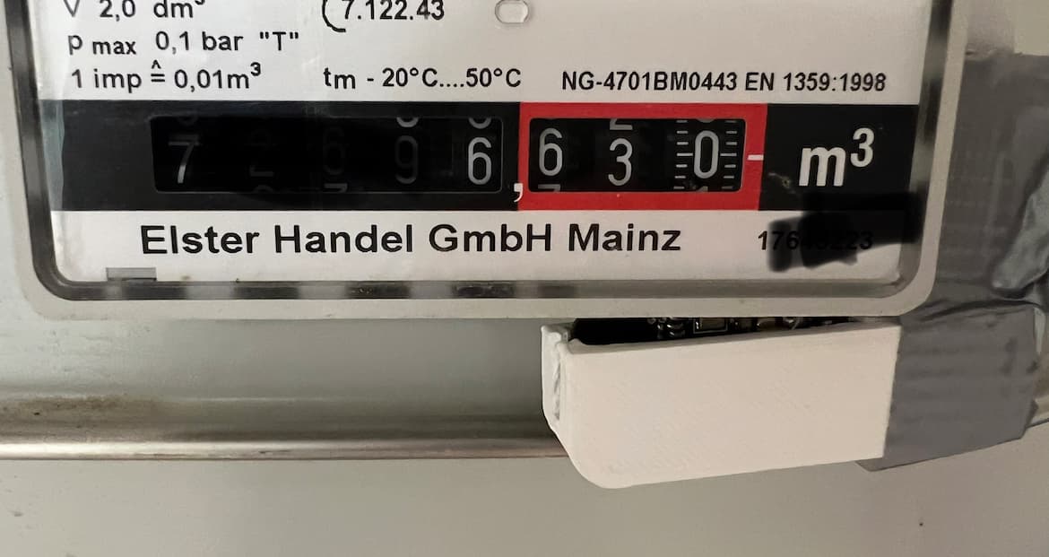

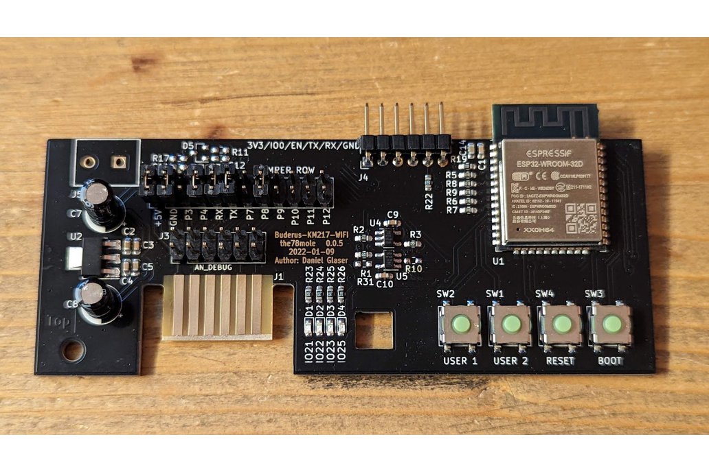

Due to the high gas prices I have tried to find out if it makes sense to optimize my gas heating. It is a 27 years old Buderus Logomatic.
I have started to attach a Zigbee door sensor on the gas meter and was able to monitor the gas consumption in real time.
This way I realized that my gas consumption, even in the summer purely for water heating, is very high.
Therefore, I wanted more information from Buderus. The required RS232 interface is no longer offered and is much too expensive. My research brought me to a replica with WLAN and MQTT protocol, which was also much cheaper.
The great part
does now for a few weeks a reliably service in my gas burner and gives me the possibility to analyze everything more detailed.

Oh this is genius! Did you also make the hardware modifications mentioned in that post? Or just use the ZigBee sensor as-is?
No real hardware modifications, I just took it out off the enclosure and into a 3d printed housing, that fits almost perfect.
It’s online since August and there has not been a single missing count or double count. Works absolutely perfect.

I don’t have gas heating, but I noticed a similar behavior with our (old) central oil heating during the summer:
I have three AC voltage sensors for the burner, water circulation pump to hot water storage tank and heating circulation pump. Additionally, a DS18B-forgottheexactpartnumber temperature sensor in the hot water storage tank. All sensors report to OH and get persisted.
Checking the graphs during the summer revealed, that the heating controller only allows a very small drop in the hot water temperature, before it starts the burner again. This uses up a lot of oil and unnecessarily keeps the hot water at minimum at the set temperature (and ~10K above).
To improve the situation, I added a solid state relay (requires next to no power during a day, compared to a mechanical relay) and a potentiometer to the hot water temperature sensor of the heating controller. I can’t remember, if it was installed in series or in parallel to the sensor, but that depends on the sensor type. The potentiometer is adjusted to add ~10K to the temperature reading for the central heating, when the relay gets activated (check with the heating service menu).
Then I have a small OH rule, that gets triggered when the pump for the hot water heating circulation pump shuts off. If the water temperature is above 55°C, then it activates the relay.
Another rule turns the relay off, when the water temperature drops below 40°C.
This small modification reduces the number of short burner runs significantly during the day.
Now, the central heating heats the water to a bit above its normal setpoint. As it stops the circulation pump, it suddenly ā€œseesā€ the water temperature at 65°C instead of the real 55°C. As the water cools off during the day, the temperature, that the controller ā€œseesā€ is still within its tolerance window, so it doesn’t heat again. As OH shuts off the relay, the controller suddenly sees too cold water and heats it up again.
An additional improvement to reduce heat loss a lot is my modification of the hot water circulation through the house: The circulation pump can be programmed for a whole day, but only in 30 min intervals (minimum ON time: 30 min). This is unnecessary, as 30 minutes is much too long and as I am no robot, I do not need warm water at exactly the same time each day.
Instead, I set the pump to always-on and switch it with a Sonoff mini zigbee relay now. In each room where hot water is available, I placed a small Sonoff zigbee PIR motion sensor.
Now, if any motion sensor triggers, a rule checks if the last pump run is more than 15 minutes ago. If yes, it turns on the circulation pump of 1 minute. If the last pump run was less than 15 minutes ago, nothing happens. This means, that the pump will always only run for 1 minute, and no more than every 15 minutes.
Now, if nobody is home or entering rooms with a sink, no heat is lost in circulating water. Also, you will get hot water any time of the day (before, the pump was off during the night). The only downside is that it can take up to 20 seconds after entering a room, until hot water is available, if the pump has been off for a long time.

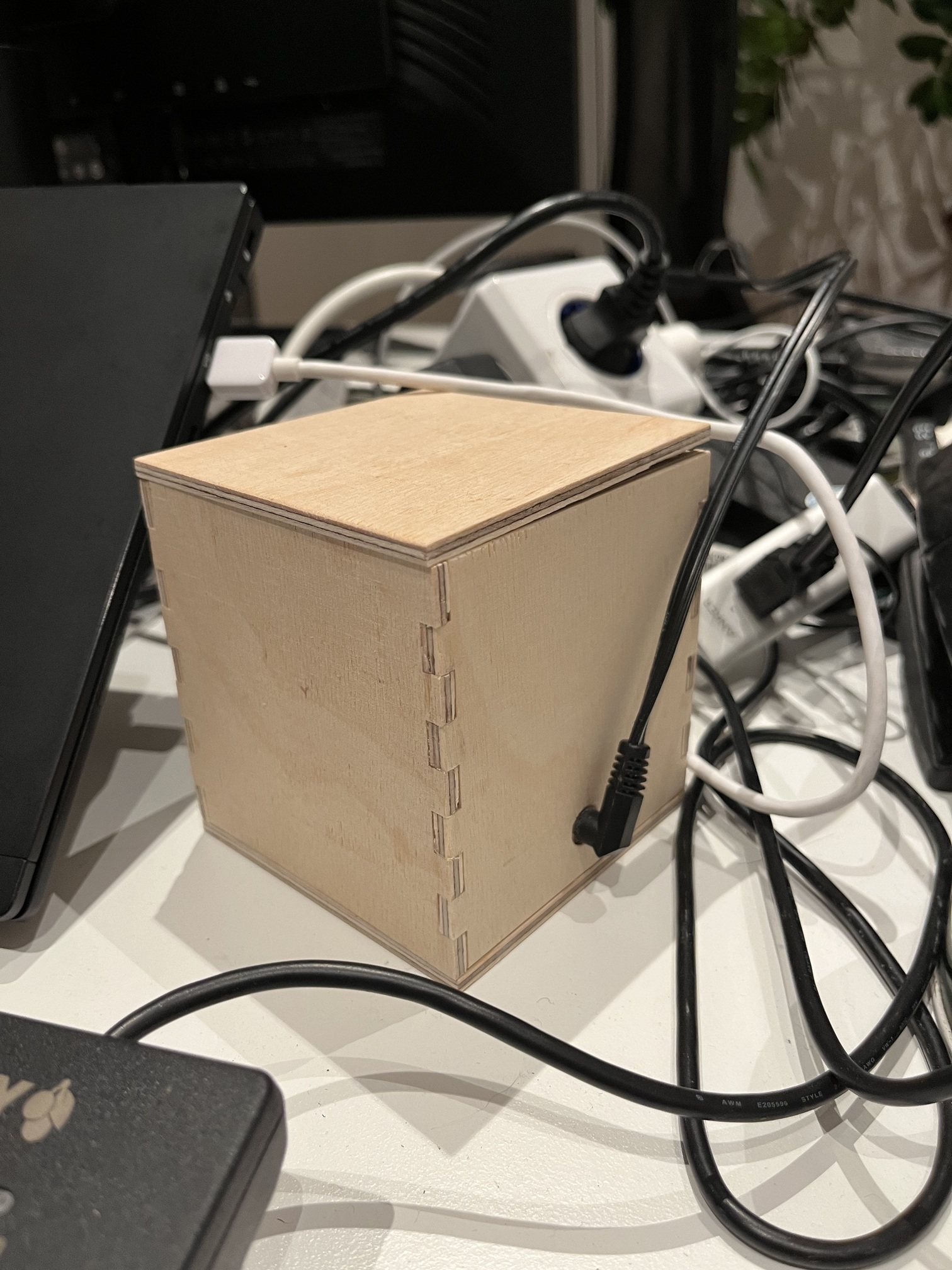

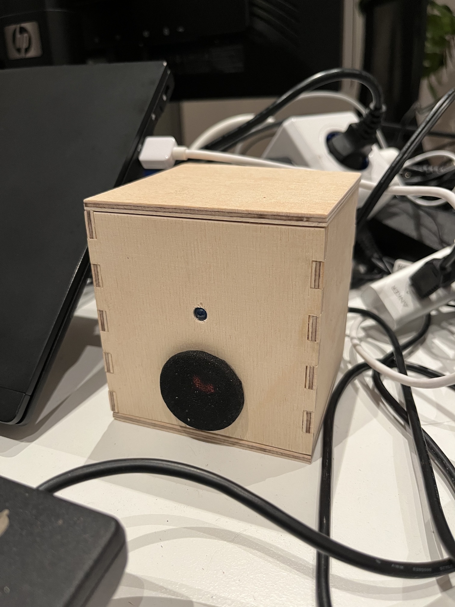

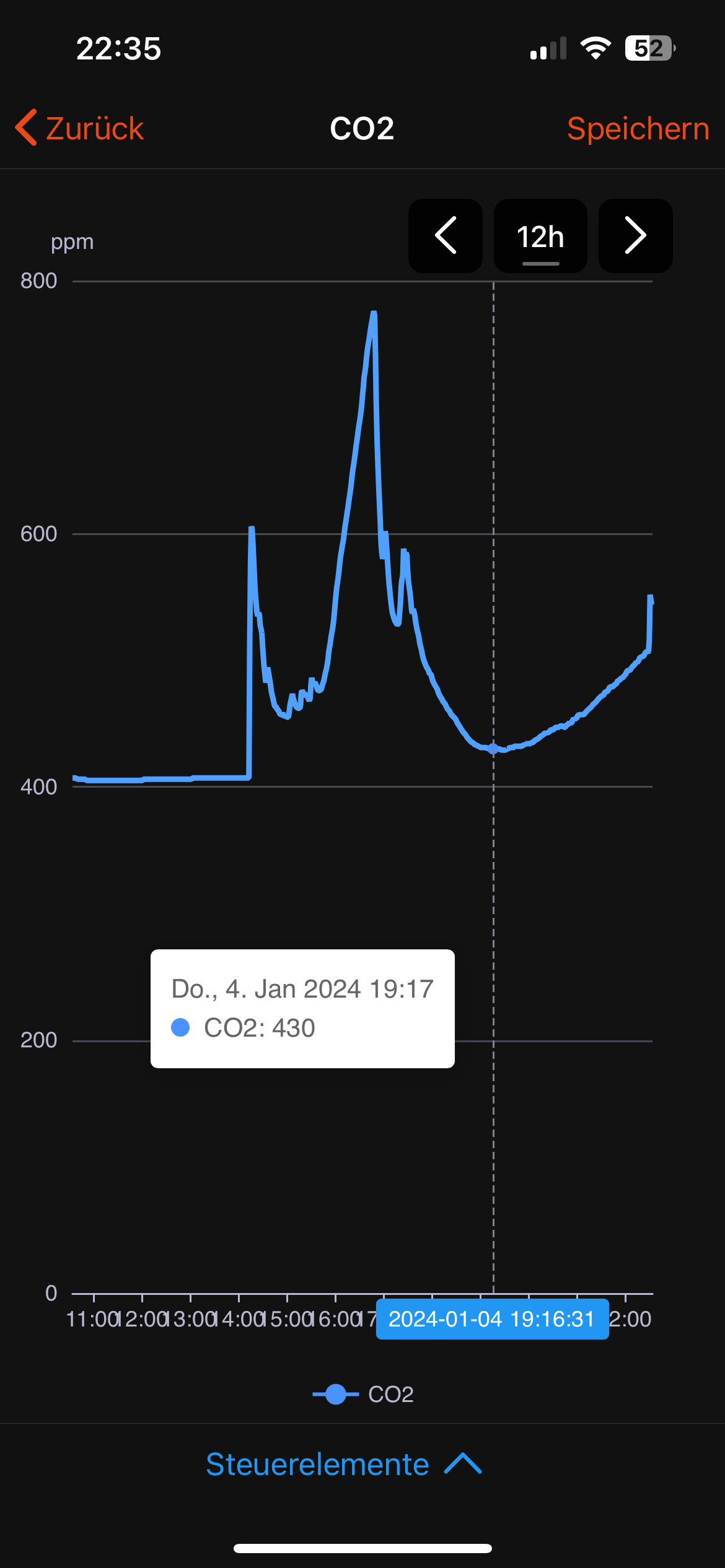

I built my wife a little gadget for the home office: a co2 sensor for the desk.
LED turns on when you should open the windows and begins to blink when the co2 levels get ā€žcriticalā€œ. It’s a build with a MHZ19C sensor and an ESP8266 microcontroller. My first use of Tasmota for this project. Of course there is an OH integration :grimacing: The box is made from 4mm birch plywood.
This is what a workday may look like (you can tell that my son still has school holidays by the late start at about 11 :sweat_smile:):
