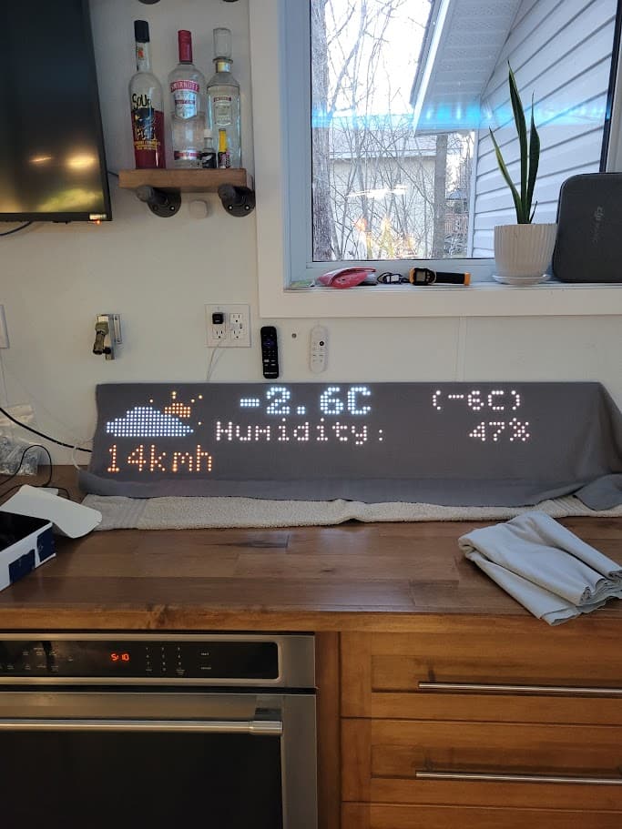

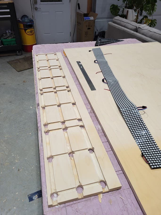

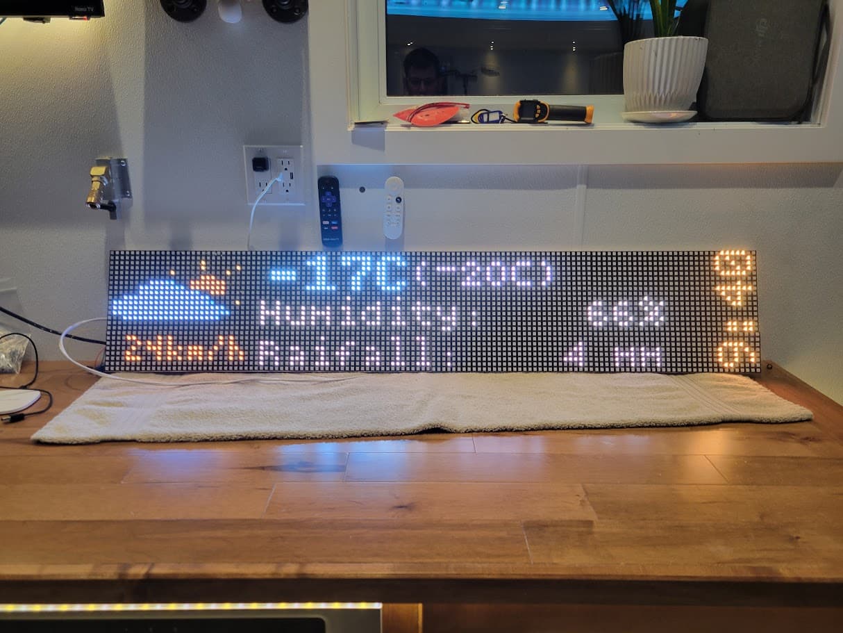

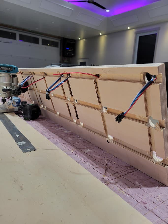

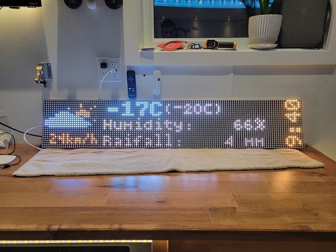

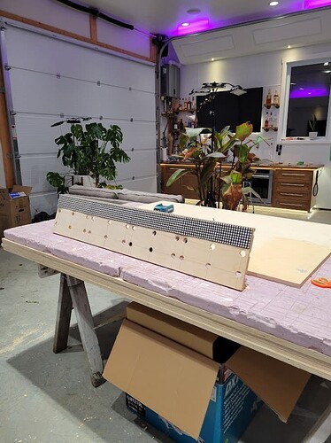

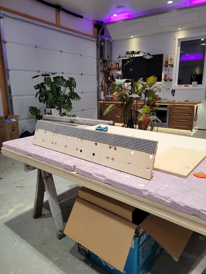

I’ve been playing with WLED a fair bit for accent lighting in my garage, but ventured into the 2D Matrix aspec of WLED to build my own LED display to show some information directly fed from openhab.
I poll weather conditions from my weatehr station into openhab and then present that information on the display i been building.
Lastly doing a fabric wrap test:

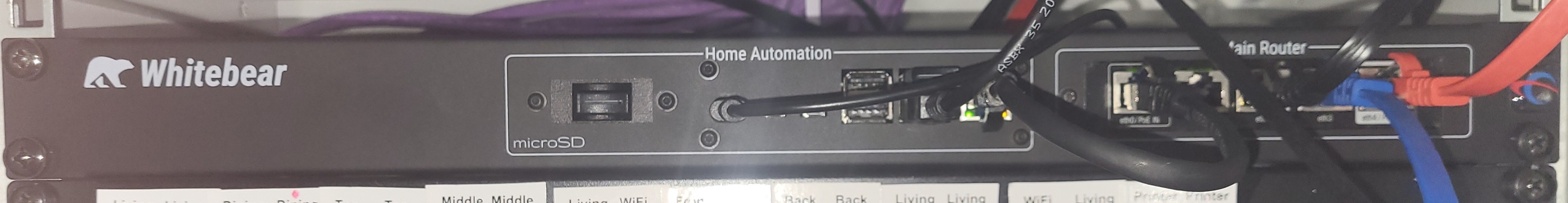

Here is my OH RPi on a custom built 19" rack..

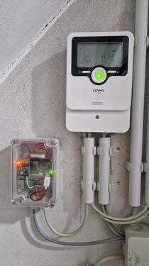

I have integrated my solar controller CosmoUno into Openhab4,
using a VBus decoder on a Raspberry Pi Zero.
For more information, feel free to DM me:
