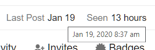

Actually, he last posted on January 19, 2020. Not in January 2019.

Ooops , you are correct. The side bar thing is a bit confusing. At the top it shows the year and for posts also the year next to the month except for when its the current year.. bad luck for me it was Jan 19 and not Jan 2019. My memory is so bad I should have known it was not that long ago!
