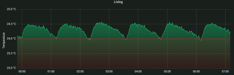

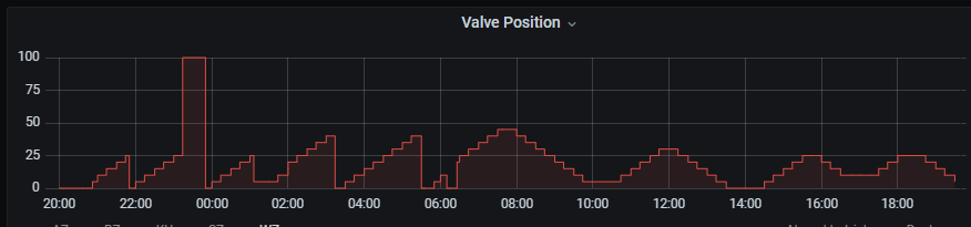

The thermostats regulate them self by de/increasing the valve position by 5% each 15 minutes.
Example:
You have to program some workarounds to prevent them from being 100% open when the central heating of your home starts in the morning., because they would take 6 hours to decrease the valve position from 100% to 0% after they reached the set point.

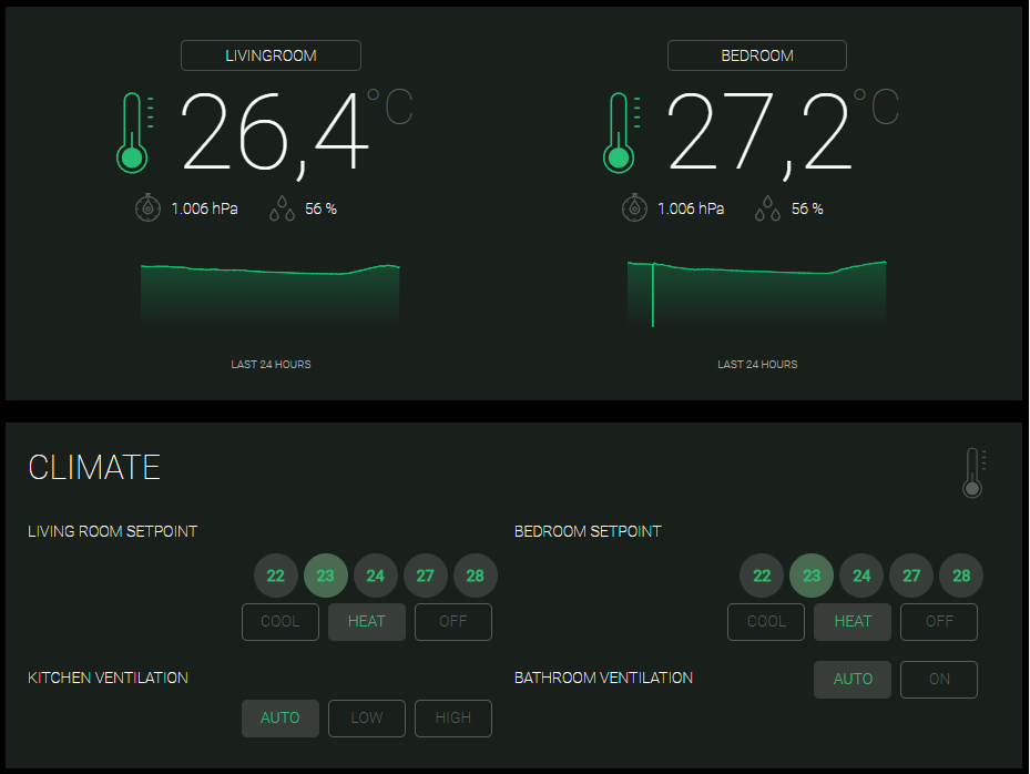

At the moment I use Force=close only to prevent the thermostats to heat to much.
During the day I think the implemented algorithm is good enough at keeping a constant room temperature by opening the valve to a specific percentage rather than 100% (Force=open) or 0% (Force=close).
Why should I program my own heating algorithm when the smart thermostats already have one?
By I will look into it.
I use it in conjunction with a gas heater so I allready use an on/off aproach for heating to control the gas heater.
Why I don’t use the algorithm of the thermostat?
  1. I don’t like that the temperature sensor is close to the radiator, I know that you can compensate this in the thermostat settings but I still don’t like it.
  2. I want to control all the heating, ventilation, cooling and so on from a central location.
  3. I have a better control of the temperature.
