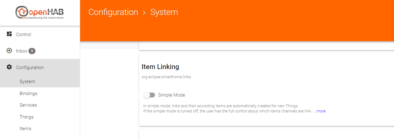

My dilemma is where are these names? I’ve never had any opportunity to create a “GF_Living_Room_Lamp” name? I am sitting in Paper UI and it seems what I’m changing is the label, not the name.
Yeah, that’s the label. Sounds like you have Simple Mode turned on, and you have allowed OH to create your Items for you.
I have Simple Mode turned off and manually add/remove/change my Items in items files (I migrated from OH1). Item names cannot be changed if created automatically or through PaperUI. You will need to delete them and recreate with your preferred names. A forum search turned this up:

But turning off simple mode only allows me to name the LINK. It had no effect on the default name created in Paper UI. I’m not worried about the names and link names at this point. Paper UI is essentially creating location tabs (rooms), and I want to give things reasonable names within those locations.

After turning it off, you will need to delete the Items and create new ones, either in PaperUI or an items file. If the former, you should be able to choose the name at creation. If the latter, then you can change the name as needed, but will need to get the channel info from the Thing to configure the item. Pick one, or try both and see which route works best for you. Either way, you should be able to quickly wipe out all your items by running smarthome:items clear in Karaf.
