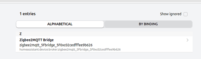

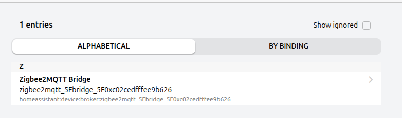

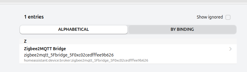

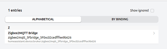

I’m pretty sure that has been changed in OH 5. I’m not seeing that behavior. I have a service running on my network that reports on all the devices on my LAN to MQTT using HomeAsistant, both IPv4 and IPv6. I’ve nearly 200 ignored Things, so I would notice if they kept coming back. Once ignored they seem to remain in the ignored list.
Before a restart:
After a restart:
