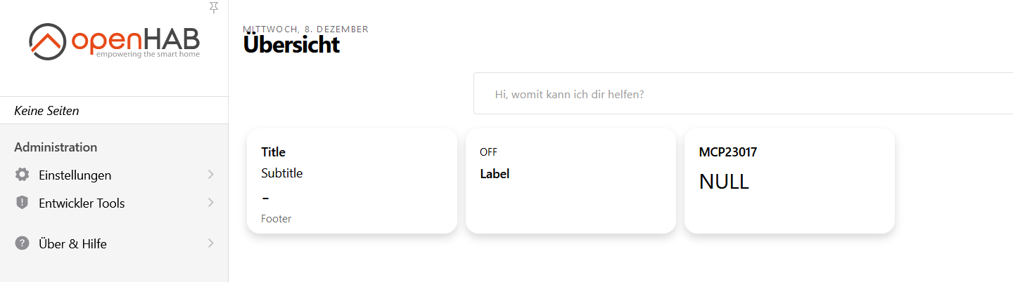

And my actual configuration is this

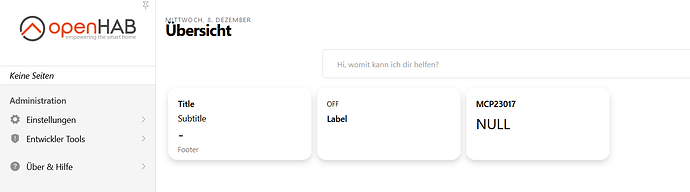

The overview has these elements like in this screenshot

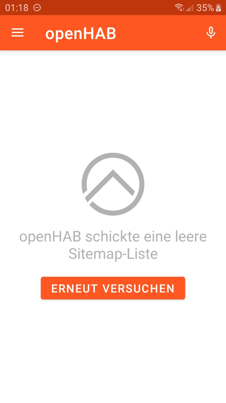

But on my smartphone I just see this
translation of the text
openHAB sended an empty Sitemap-List

This is the message shown on my smartphone

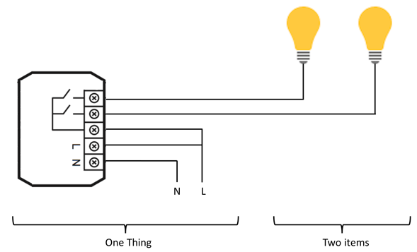

Imagine a room inside your house with a double-switch mounted into the wall for switching on/off two different lightbulbs.
Imagine a TV-remote-control with all its keys to switch on/off, change the TV-program, change volume etc.
In OpenHAB such objects like the double-switch, the TV-remote, a single switch etc. are called “things”
Now let’s take a closer look at the “thing” double-switch:
The double-switch is able to
  • switch on/off lightbulb “A”
  • switch on/off lightbulb “B”
Lightbulb “A” and lightbulb “B” can be switched on/off separately and indipendend from each other.
This means the double-switch has two functions.
The same principles apply to the “thing” TV-remote-control.
The “thing” TV-remote-control has a lot of buttons where each button has a different function to
  • increase / decrease volume
  • increase / decrease brightness of the screen
  • change between different TV-programs
    etc.
The double-switch is able to switch on/off lightbulb “A” and lightbulb “B” independent from each other. In OpenHAB the capability to switch on/off is called a “channel”.
This means the one “thing” double-switch has two “channels”
A wall mounted switch on its own without additional objects is useless. The double-switch is part of a system that has more elements than just the double-switch. There are wires coming from the electrical cabinet which are connected to the double-switch and there are some more wires one end connected to the double-switch the other end connected to the socket of the lamp that holds the lightbulb.
