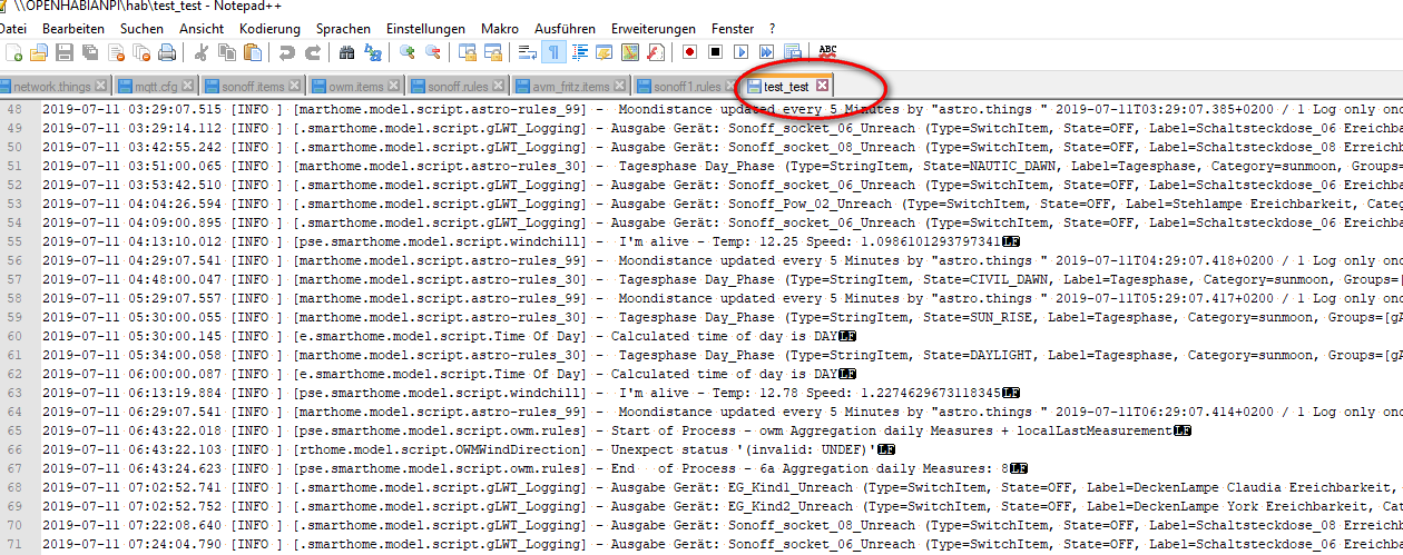

I made the following:
1.
tail -100 /var/log/openhab2/openhab.log > test_test
to get some lines from the log-file and bring the output to another file ( in may case it’s “test_test” in my home-directory). And the result of the file-command you can see above.
Go with your Editor to your home-directory and open it
