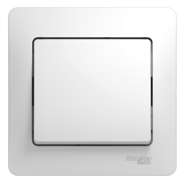

A physical switch is a bistable switch attached directly to the dimmer. Like the one at the image:
So it’s neither z-wave device nor controlling/controlled by OpenHAB directly.
