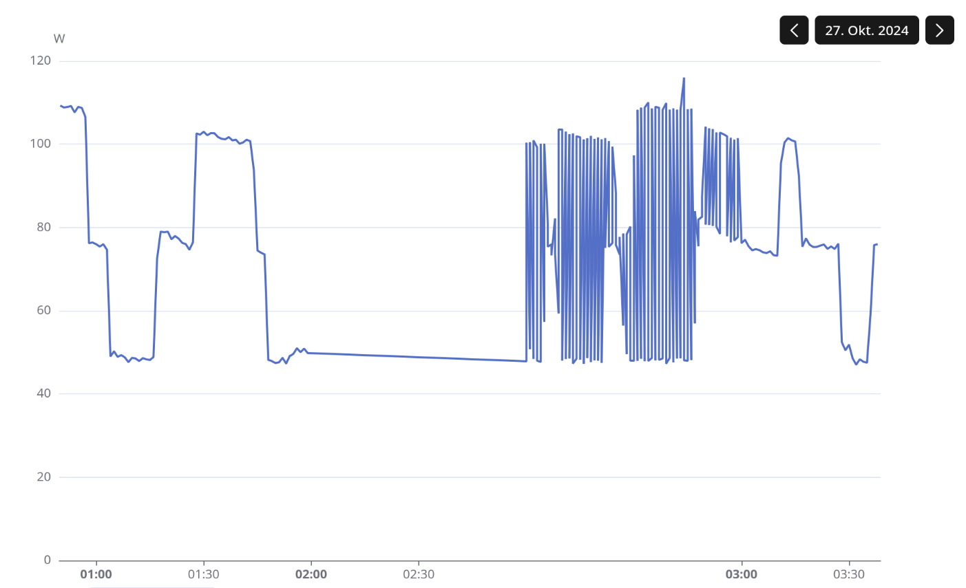

I’m not accessing sqlite directly, it is all through openhab. The data is stored by persistence and the timezone information is then already lost. And if I retrieve it in a plot it looks like this:
One hour has no data and the next double values.
Thanks for the hint. jdbc seems to have several timezone issues.
