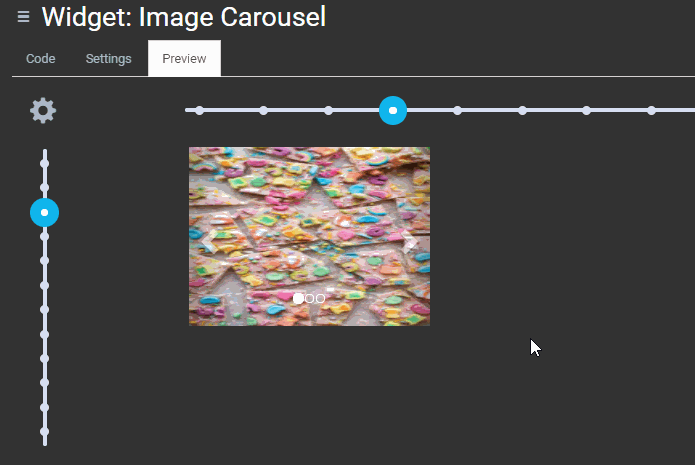

[Widget] Image Carousel
Image Carousel
Rotates a list of images
Image Carousel.widget.json (4.5 KB)
imgCarousel
Settings are self-explanatory.

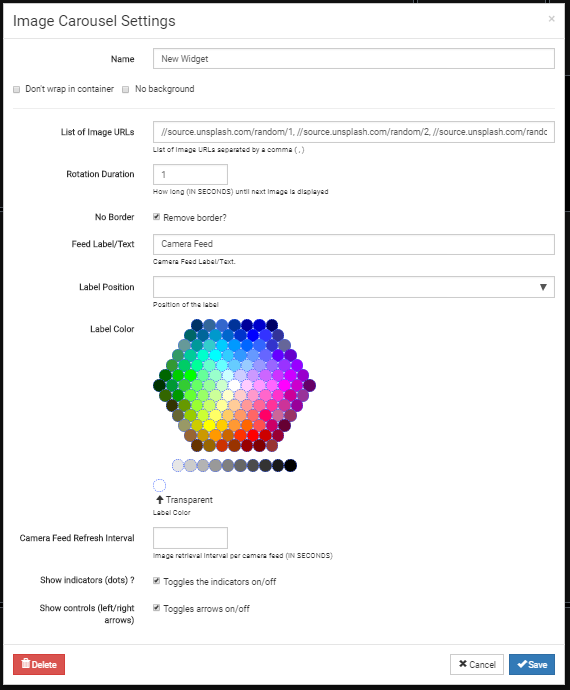

Is there a way to turn off the circles and the arrows? Nothing jumps out in the code.
The indicators?
.carousel-indicators { display: none }
I’ll probably modify it to make it a configurable setting.
Excellent. That did the circles. What about the arrows?
Tried:
  .icon-next {display: none}
  .icon-prev {display: none}
But that wasn’t it.
Done. Just reimport the widget from widget gallery. Indicators and arrows are configurable now
That is really cool how fast you did that. Perfect. Thanks again!!
