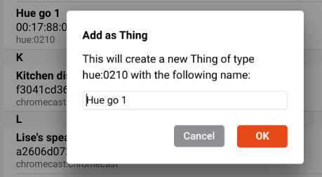

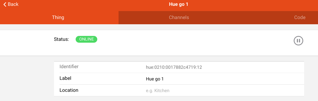

I don’t see how? Below is what I see when adding from the Inbox, as well as from the discovered items if I look at the hue binding only.

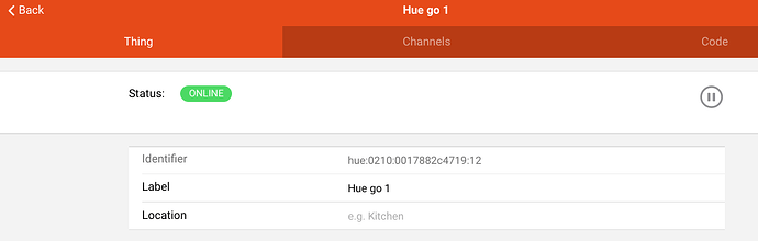

And of course once this has been added, the UID isn’t editable in the Things UI:
I wasn’t willing to risk deleting my bridge and losing my config to try with the bridge… I am willing to try, I guess I can just backup userdata/jsondb?
You are right, when adding from inbox, the uid field is missing. This was definitely possible in PaperUI at openHAB 2.x
@ysc, is it possible to add this missing feature to MainUI ?
I very much doubt it, since the API doesn’t allow it. @Lolodomo has proposed to change that, the issue is posted above.

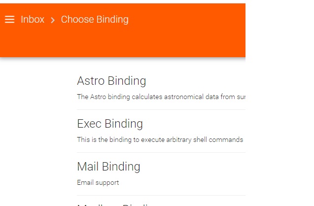

Pick a binding

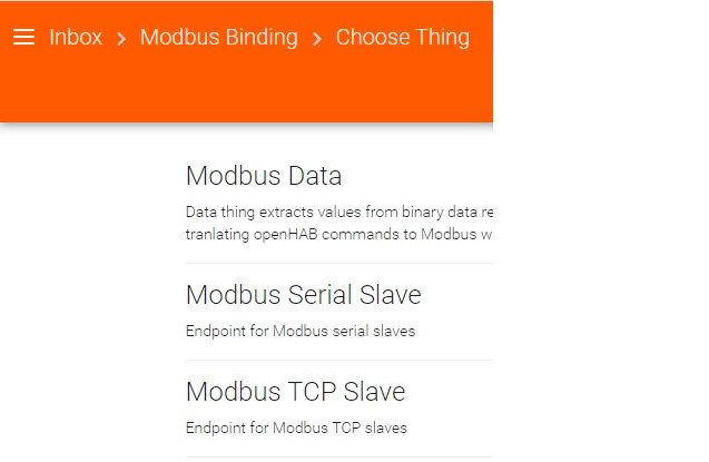

Pick an offered Thing type - in this case, a Bridge type

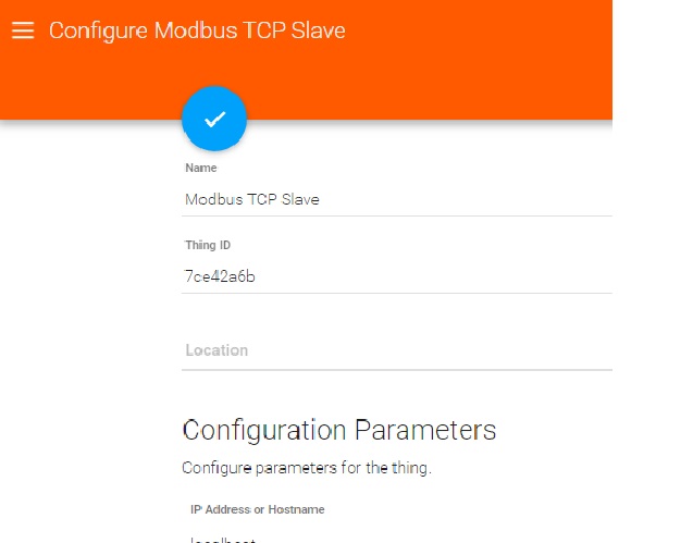

Get offered to configure it, note auto generated UID fragment

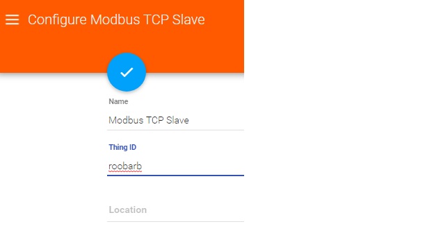

But you can type a meaningful replacement over that, before saving.

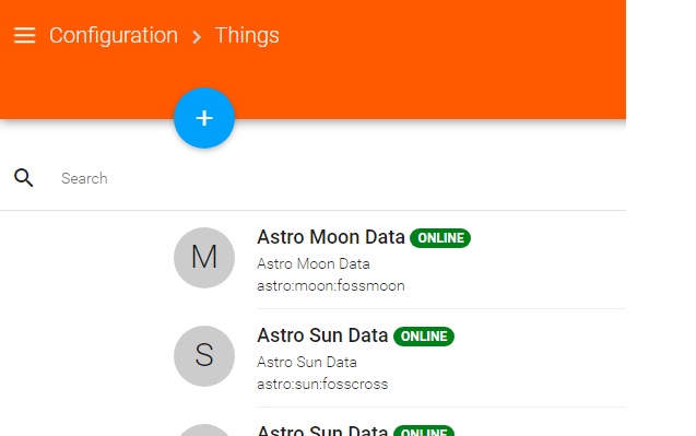

And we can make sure it really did create a Thing with that UID
Indeed, my bad, adding manually allows to set the id, but not while approving from inbox.
