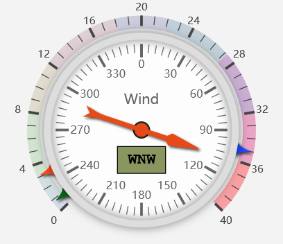

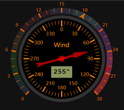

The widget works fine with my Ecowitt Wittboy weatherstation in a tabbed popup page of my openhab screen. I have adjusted the radius of the first oh-data-series from 72% to 100% to fit an my dark screen background and have added “speed km/h”. You possibly could adjust a text like this on the bottom (between 0 and 40) of your widget … so thats clear what the numbers on the outside mean (without looking into the tooltips).
The reason I didn’t add units to the numbers are that I would have to make the widget even smaller, and the smaller it is, the more “fuzzy” the details get. I also assume that most people use the wind speed unit that “they are used to”, for me for examle, wind speed “is” m/s - so I would never expect it to be something else. The text in the widget is editable (where it says “Wind”), so one could add the unit there.
I don’t know if you have discovered the “advanced” button in the widget configuration, but if you click it, you can also adjust all the colors so that it fits better to a dark background.
I thought about a “wind speed text” like this:
… not units by the numbers

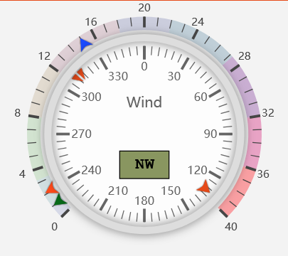

I discovered the “show advanced” and adjusted the colors:
  • green: for wind speed and wind direction
  • orange: for guest speed
  • red: 3rd wind speed (todays maximum wind speed)

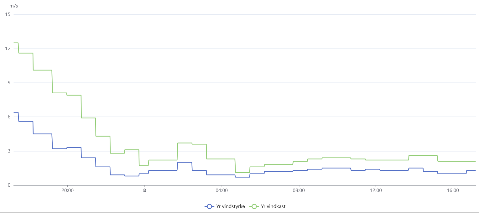

Tooltips no longer work when I activate “Show Speed Chart”
Thanks again for the widget!

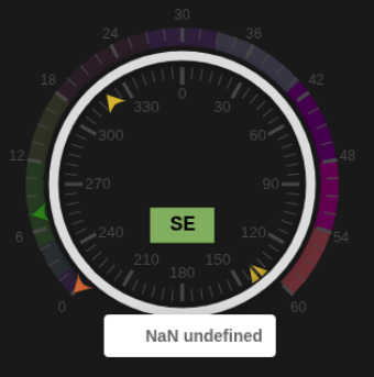

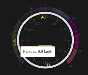

Here whenever GustSpeed (Rajadas in portuguese) is zero (0) tooltip shows as NaN undefined.
I’ve looked at this, and I think the problem is different than it appears. There is support in the widget for a 3rd wind speed indicator (e.g. max gust last 24 hours etc.), and when it isn’t assigned an Item, its value is “NaN”. The needle itself is hidden when it’s not assigned to an Item, but it stays at “zero” while hidden. It seems that the tooltip for this is still active, and this is what you see. Because the 3rd indicator is defined “on top” of the other two, its tooltip will “win”.
I have managed to hide the tooltip as well, but it still doesn’t make the tooltip from the “gust” appear, it just means that no tooltip will be shown at zero. I don’t know if there’s anything I can do about this, as this functionality is controlled by Apache echarts and I can’t find an option to completely disable a data source conditionally.
@JustinG I assume that you don’t have any handy tricks up the sleeve here? I guess this is an echarts issue, not a widget issue, so probably not..?

Thank you for your return.
I wasn’t complaining I just meant to warn you about what I found in my setup.
You are completely correct about the reason for the “NaN”.
I hadn’t configured the 3rd indicator or even the 3rd indicator tooltip.
As soon as I made the configuration, the “Nan” information disappeared when gust speed is zero.
Thank you for the excellent widget!
