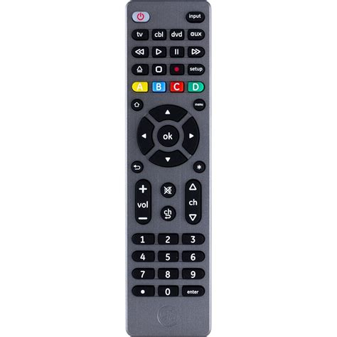

Over all, at least in the commercial space, the smart home is at the stage as home theater systems were back in the days of the late 1990s and early 2000s. Either you had one remote for the TV, another for the sound, one for the DVD player and maybe another one for the cable/satelite TV box. Or you had one of these monstrosities:
and a three page set of instructions to explain to the babysitter how to turn on the TV and change the channel. “First turn on the TV by pressing TV and then the power button. Then turn on the stereo by pressing aux and the power button. If the stereo doesn’t say BD123 hit input until it says BD567. …”

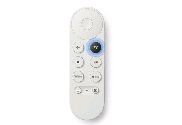

Today with streaming devices, sound bars and CEC all we need is a single very simple remote
It’s simple and intuitive enough for even a guest to use and everything is controllable from this one remote.
