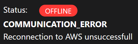

Other issure: I just have seen that the API brigde lost the connection over night “Reconnection to AWS unsuccessfull” (reconnect Interval: 250sec). Disabeling and Enabling the thing gets the bridge online again

which settings you are using? My connection is lost after about 12h…
Reconnect Interval: 250sec
Refresh Status Interval: 300sec
Polling Interval: 3600sec
When I disable/enable the Bridge it works again.
Mine stopped working yesterday completely.
Nothing helps: disabling/reenabling the Bridge and Mower thing, restarting the binding, restarting openHAB, restarting the server :joy:
