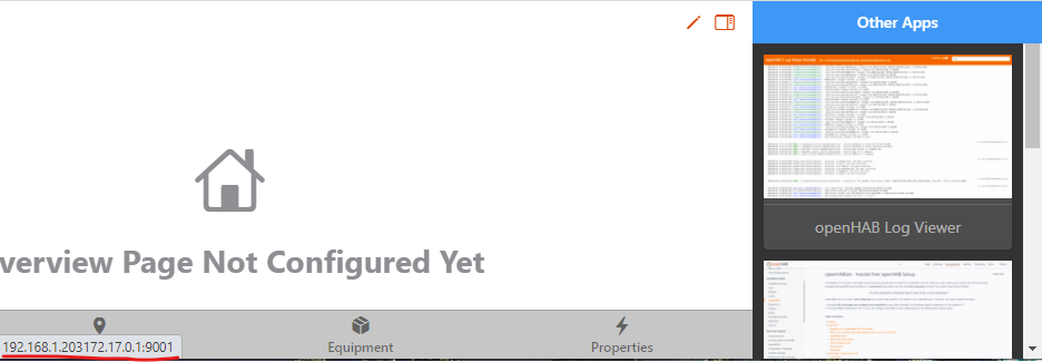

I’ve just updated my Openhab installation from 2.x to 3.0.1. Had some problems with making it work, however after reinstallation of Java it started to operate normally. At least this is how it looks for now.
What I’m struggling with however is accessing frontail through web gui.
This is url opehHAB Log Viewer is pointing to:
And this is what I have configured

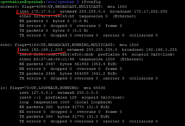

It looks that frontail url is right now sum of my local and docker address. When I change it manually to 192.168.1.203:9001 it naturally works.

I asume it somewhere during the first setup “learned” the adress of the local interface, which may was assigned to it by my DHCP, as I ordered my DHCP after first boot of the openHABian image to assign another IP adress to the device.

this explains how to fix it:
in short u can find runtime.cfg in /etc/openhab/sevices (or if you did activate the recommended smb drives at your openHAB-conf drive.
replace the adress listet there with the correct one.
