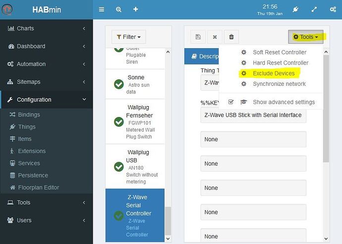

IIRC I set the controller to exclusion mode via Habmin and hold down the tamper switch for one second. It didn’t work the first few times, but it did at some point :slight_smile:
EDIT: wrong in-/excludion method here :slight_smile: not 3 times, hold for one second and release the tamper switch

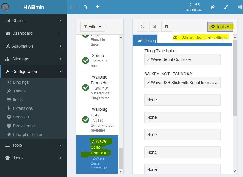

You have to activate the advanced settings first:
@DocFraggle:
Thanks a lot for your reply, but the keypad is currently not included in the zwave network (as I resetted the controller). So normal exclusion is not applicable.
All my other zwave devices can be (forcably) resetted, e.g. when the controller is no longer working or got resetted.
But I can’t find out how to perform that with the keypad.
regards
Stefan
Yes, I got that, but the process I described is the way to reset the keypad
to factory settings!
For clarification, here an excerpt from the manual:
EXCLUDE INITIATOR
The exclude initiator is used by Primary and Inclusion Controllers to
exclude nodes from the network. When the exclude initiator and a
slave initiator are activated simultaneously, it will result in the slave
being excluded from the network (and reset to Node ID zero). Even if
the slave was not part of the network it will still be reset by this action.
