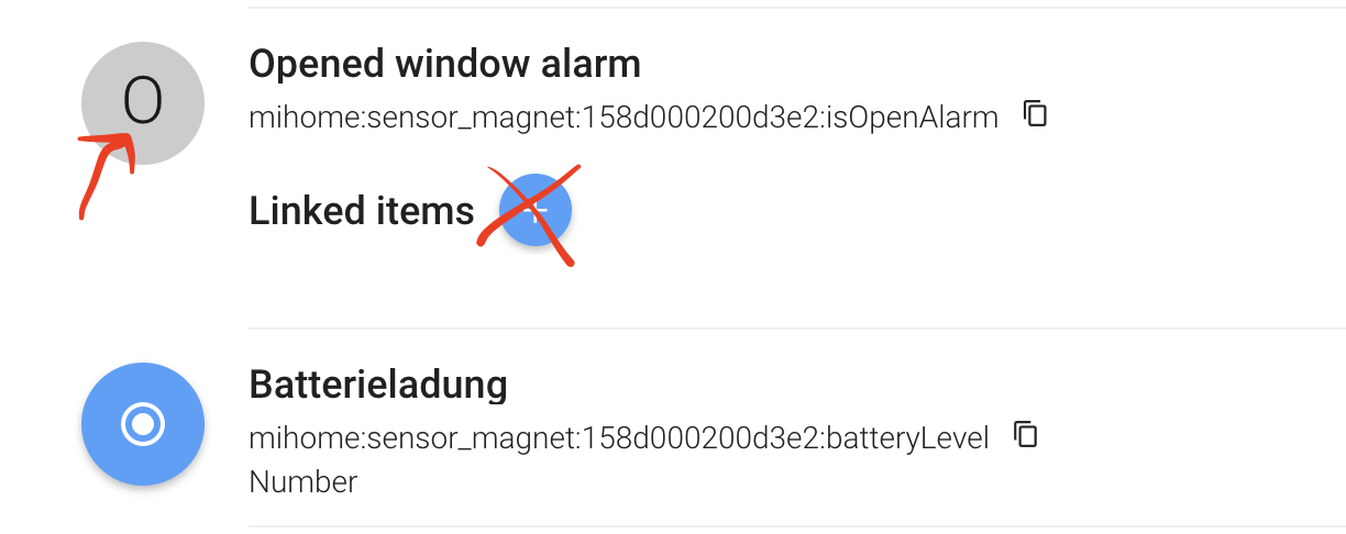

Unfortunately this is not possible… Under my thing, I see all the possible channels. All of them are likable to an Item except isOpenAlarm… linking is denied.
