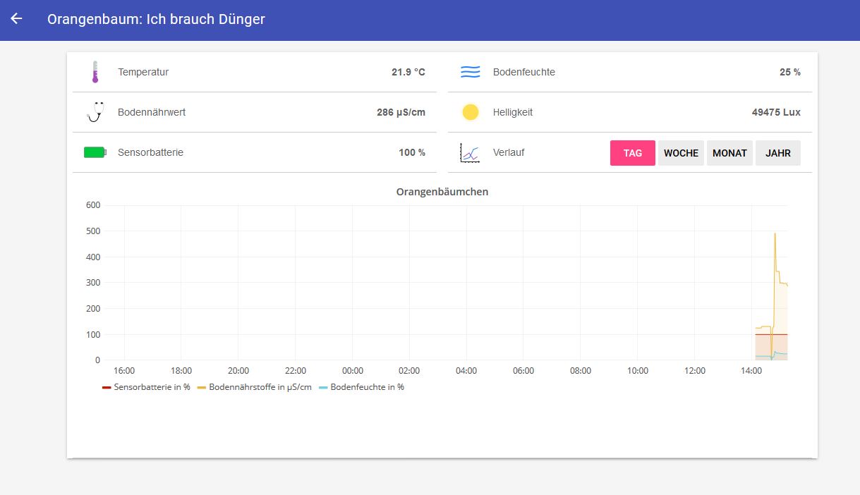

@Simsal I’m not sure what you mean. I’ve never compared with the app (actually barely used it). Are there systematic differences or are you just seeing slightly different readings?
Hey @rlkoshak the range is not great. I’ve implemented 3 retries per sensor per cycle and am seeing a 90% success rate for one of my sensors located 7 meters away with just a bit of furniture and a balcony door in the direct path. Another sensor around the corner has a success rate of 50% and one in the another room separated by two walls with 0% (no surprise here).
Be aware, that I’ve set up 9 sensors. All others in closer proximity are not listed in the screenshot. It’s also easy to improve the link quality by moving the plant or sensor position in the pot slightly. The readings you are seeing in the screenshot are from my deliberately bad positioned testing sensors.
One great thing about the daemon is, that it can easily run on a RPi0W in another corner of the house.

Installed it, but not sure about broker.url=tcp://localhost:1883
[13:15:30] openhabian@openHABianPi:/etc/openhab2/services$ vim mqtt.cfg
# Define your MQTT broker connections here for use in the MQTT Binding or MQTT
# Persistence bundles. Replace <broker> with an ID you choose.
# URL to the MQTT broker, e.g. tcp://localhost:1883 or ssl://localhost:8883
# Optional. Client id (max 23 chars) to use when connecting to the broker.
# If not provided a random default is generated.
#broker.clientId=<clientId>
# Optional. True or false. If set to true, allows the use of clientId values
# up to 65535 characters long. Defaults to false.
# NOTE: clientId values longer than 23 characters may not be supported by all
# MQTT servers. Check the server documentation.
broker.allowLongerClientIds=false
# Optional. User id to authenticate with the broker.
broker.user=openhabian
# Optional. Password to authenticate with the broker.
broker.pwd=xxxxxx
# Optional. Set the quality of service level for sending messages to this broker.
# Possible values are 0 (Deliver at most once),1 (Deliver at least once) or 2
# (Deliver exactly once). Defaults to 0.
broker.qos=0
# Optional. True or false. Defines if the broker should retain the messages sent to
# it. Defaults to false.
broker.retain=false
# Optional. True or false. Defines if messages are published asynchronously or
# synchronously. Defaults to true.
broker.async=true
# Optional. Defines the last will and testament that is sent when this client goes offline
# Format: topic:message:qos:retained <br/>
#broker.lwt=<last will definition>
No incoming values for miflora. :confused:
Should I install the MQTT-Actions addon?
I’m confused about the following message, when I do python3 /opt/miflora-mqtt-daemon/miflora-mqtt-daemon.py
[2017-08-27 09:41:49] Generating openHAB “miflora.items” file …
I don’t see a file named miflora.items. I only see my own MiFloraPlantSensor01.items
But there are items in PaperUI > Configuration > Items:
grafik
Config looks good. Check openhab.log to learn if the broker is connecting successfully. After that’s the case items bound to correct topics should update.
Nope. You are not sending any data back.
My bad. The message is misleading. The program is only generating the command line output. Writing to a file is your responsibility (I am not going to mess around in the end users openHAB config).
The whole feature is not finished yet. I intended to add command line arguments and then only generate the items after an explicit command, something like:
python3 /opt/miflora-mqtt-daemon/miflora-mqtt-daemon.py --generate-oh-items
I hope so :slight_smile: These are the ones defined in your MiFloraPlantSensor01.items
Seems like broker is connecting successfully.

Hey, I’ve added a another change improving the openHAB items function. The function is now called with
python3 /opt/miflora-mqtt-daemon/miflora-mqtt-daemon.py --gen-openhab
and now also includes groups for all Mi Flora sensors as well as per sensor.
https://github.com/ThomDietrich/miflora-mqtt-daemon/commit/8213dd3c2971e256464df53022ae3a6ba9ae28a2
@anfaenger you need to go at your issue step by step. That’s nothing anyone can do easily for you… :slight_smile:
Your log says the connection was established. Wonderful. First make sure that messages by the plants are indeed published to the broker. Use a stand alone broker for that. I can recommended mqtt-spy. Next check if your openHAB items are properly set up with the correct topics (the generated topics should be okay). This should not be problematic. Just give it a shot :wink:
Have tried the new command. It works very well.
And with copy & paste I put the listed items in my item-file.
Did not understand the first, but now I’ve got it.
Very helpfull! :+1:
I’ll trie that.
Thanks.
it works… thx @ThomDietrich
