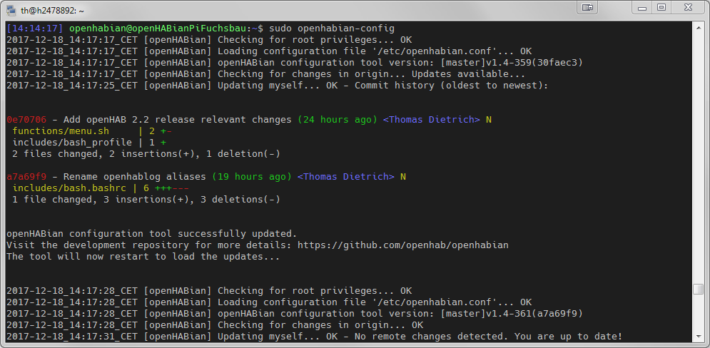

Got a problem here. Wanted to update, so i executed “update” in openhabian-config and then this came up.
Any ideas?

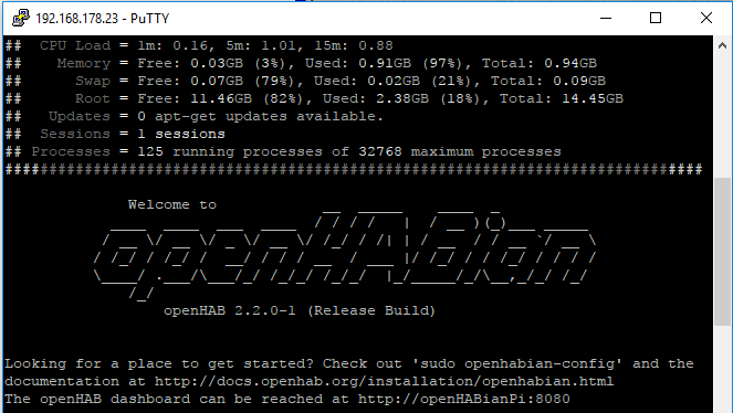

EDIT:
Now i started the “UPGRADE” function under sudo openhabian-config. After that was successfully i wondered about that?!
OpenHAB 2.2.0-1 release build?
It seems that the update has been done?!
Hello @Boogieman,
something is weird with your openHABian configuration menu. It is not able to update itself out of a to me unknown reason. Good news: It appears you are on the latest openHAB version!!
To repair openHABian, please execute line by line:
sudo rm -rf /opt/openhabian
sudo git clone https://github.com/openhab/openhabian.git /opt/openhabian
That should be it. Select “Update” to verify it’s working.
Btw you should change your default password :wink:
