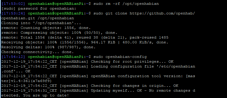

Changing the system password (linux) didn’t work via openhabian-config, I had to use “passwd” instead. Am I missing a step?

Are you really referring to the system user ? I have that problem with the Samba password.
(and filed a PR to fix it for Samba).
2017-12-19_21:45:05_CET [openHABian] Changing password for samba (fileshare) account “openhabian”… Failed to add entry for user “openhabian”.
OK
Yes, the system password.
However I suspect the problem to sit in front of the screen. I was able to change that password in the previous edition, but I failed to get the one for the Karaf console changed. This time it was the system password, I didn’t even try the one for the console.
I’m starting the config tool with sudo, IMHO I can’t do anything wrong in the procedure to change a password.???

Do I understand correctly, when using “openhabian-config” initially (without sudo) I’m getting the message that sudo is needed, input with sudo, confirming with password and then it should NOT work?
Then you are doing everything correct.
This sounds strange to me, do you get any error in the console while running the password change function?
No error. The passwoRd just didn’t change. Tried it two times and then changed it via passwd.

Hello Michael,
sorry for the late response. This is a bug which was also reported by another user. Please see here for the solution. Good luck!

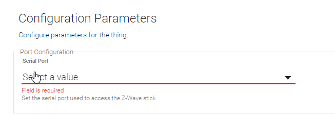

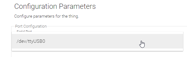

I’v installed the new image and want to make is now happen. Because after several problems and installs it must be now the final version for some time :wink:
When i want to add the new z-wave controller and want to add the controller. I only can choose whats available. I cant write down my own serial port? Is that correct?
In the other versions i can write down the serial port i want. In this version i can only choose from a dropdown menu.
I know it is a verry dumb question… :blush:
No dont think this is correct. I have a RazBerry2 expansion card on my RPi3 ( thats the z-wave adapter i use ) and in this Serial Port field manually filling in the serial port is the only option.
I think the experts on this have to know what brand/type Z-way adapter you are using.
