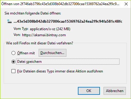

The download link from bintray gives a forbidden message :frowning_face:

I can’t get the image downloaded: I get 403 forbidden

The link is working again. Thanks!
thx!
