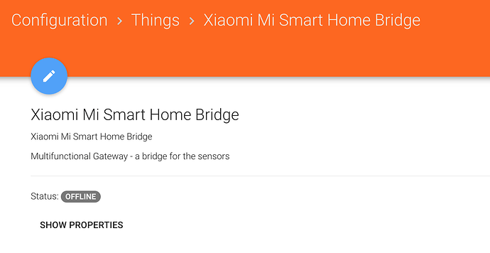

The choice of the ‘wireless communication protocol’ (steps 4&5) is required which I’m unable to do, without having access to the China Mainland locale of the app.

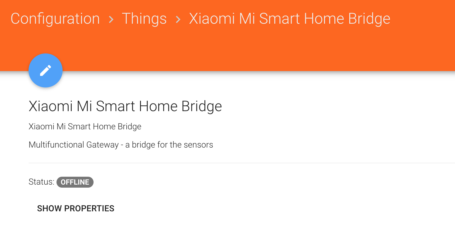

Regardless of not being able to make this option, I have attempted to connect to the binding and it is not successful. i.e. the binding remains offline.

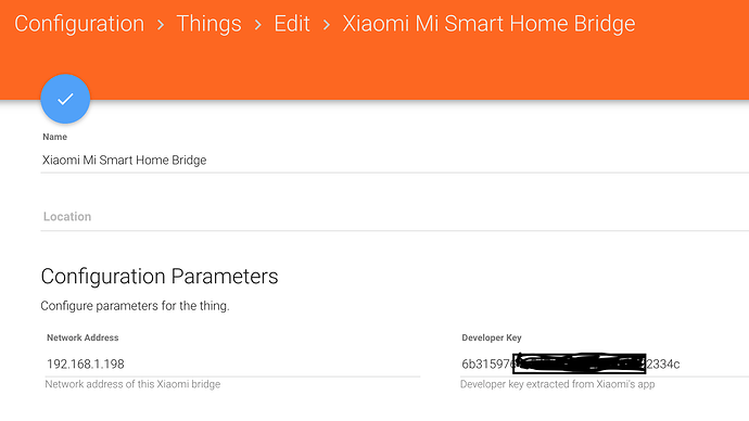

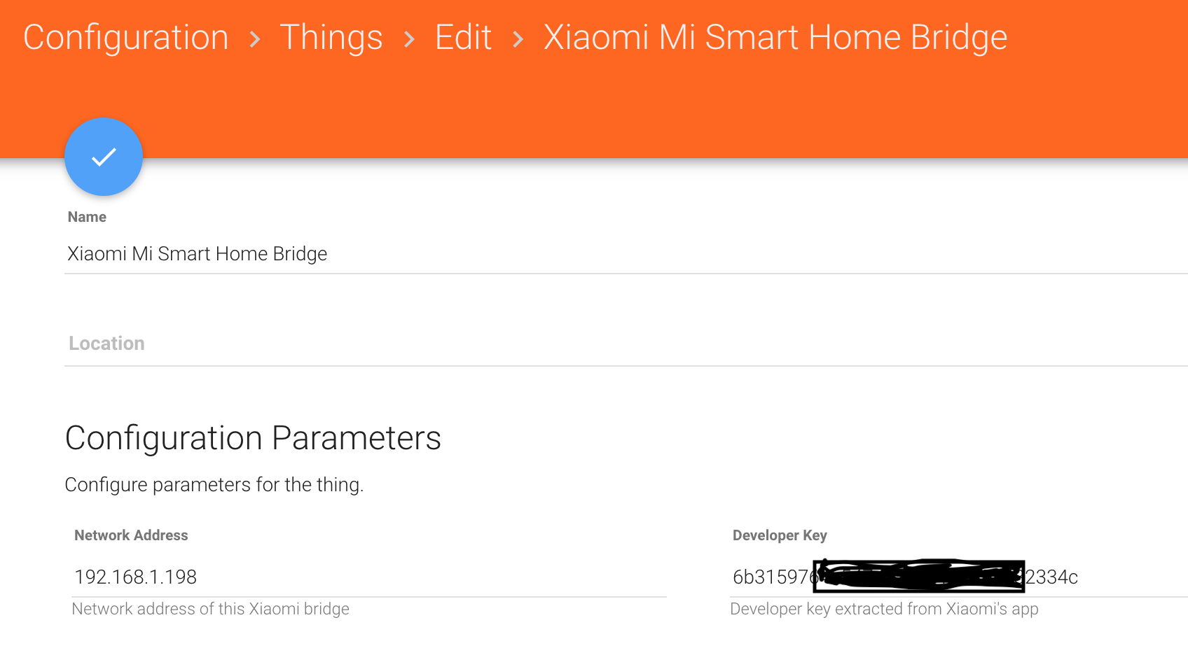

EDIT. Just noticed, it doesnt look like the correct key you´ve found. Mine looks very different. (But my hub is a chinese hub, that may be a difference).
I think that you used the token instead of the developer key.
The only way I know to find the developer key is looking in the Xiaomi app.
The token Is not used in this binding

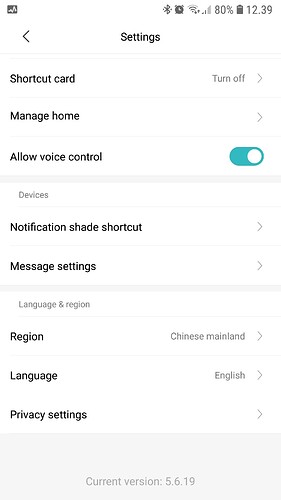

Don’t you see this page when you go to “about”?
Enrico,
I can’t get to this screen as I don’t have the ‘About’ option in the App.
This option is only available in China Mainland version of the App.
My hub doesn’t not pair/connect with this China version of the App, even though it does connect when the app is set to other global regions. However, when in these other regions, the About option is not available.
So infuriating.
Which version number and region of the app are you using in your screen shot?

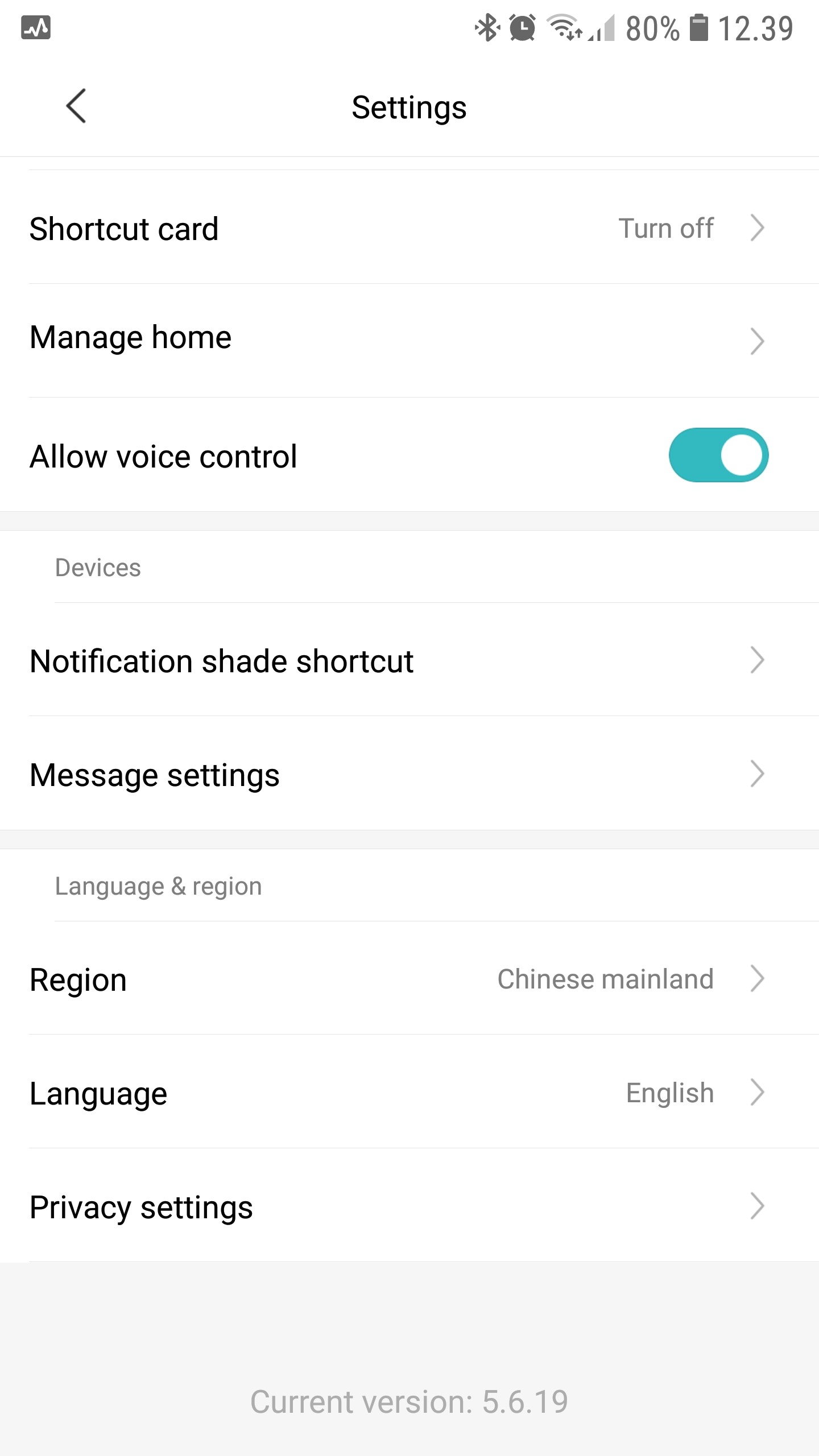

I´m using the latest version found on Play store (android). It has the “about” option allright..
Yes, but please could I check that you’re using the China Locale AND you have managed to connect to your hub?
This is the combination is what I cannot achieve.
I envy your set-up as this is sadly what I’m unable to do. I cannot connect to hub when locale is set to China. I can connect to hub when connected to other countries.

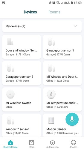

See below:

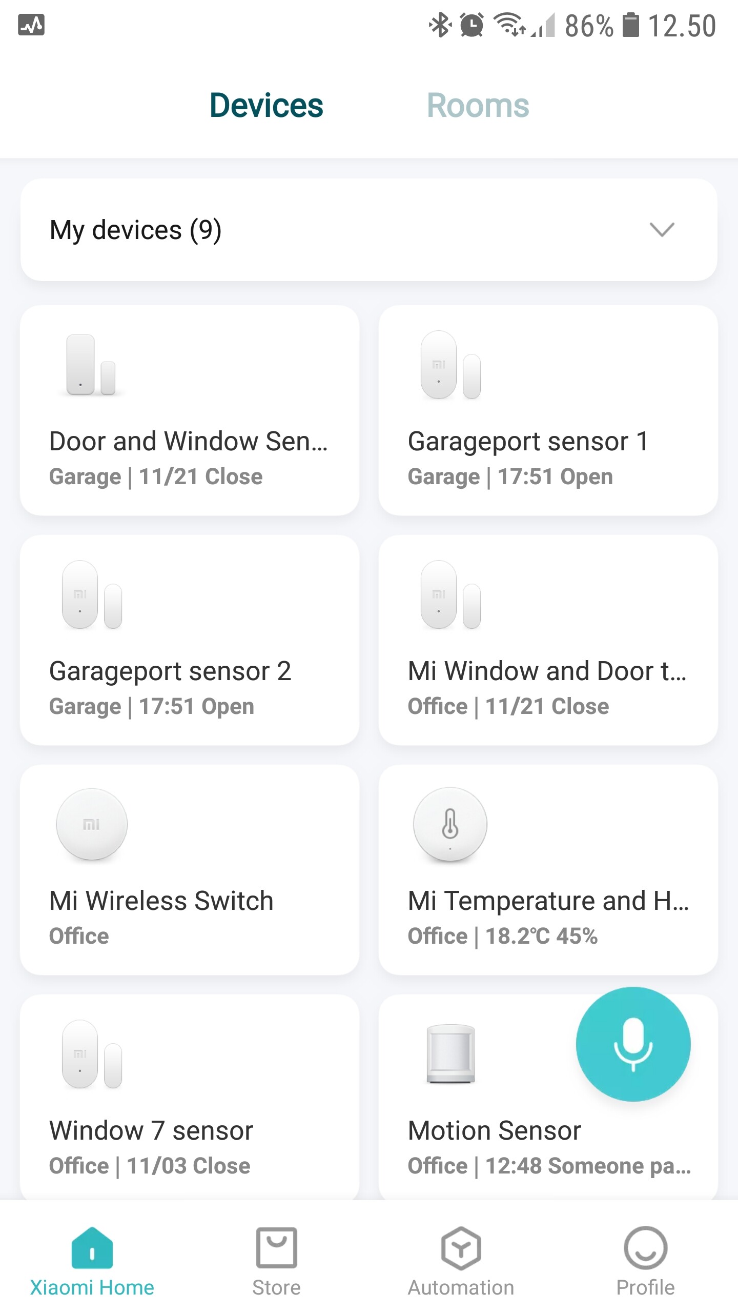

Here are my devices set-up and connected with UK server.
Note I cannot obtain a About menu item when in UK:

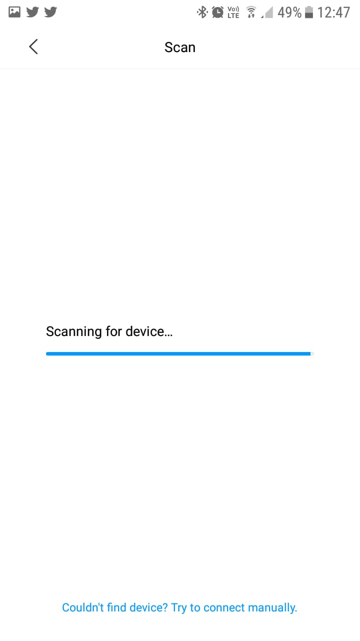

Then I connect using my location as China Mainland:
When in China I try to reconnect devices, as there connection is remove when changing to new countries:
As can be seen I am unable to connect. Which means I am unable to access any About menu item.
