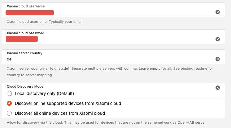

I have the same issue.
  • I copied the user name and password from the openHAB binding and used them to login to the xiaomi cloud and it worked fine.
  • I made sure the locale in the cloud is the same like the one I defined in the config (de)
  • I then resaved the configured to tell he binding to retry.
Unfortunately, I get the error message. Here a the debug logs.

2025-07-05 13:17:28.465 [INFO ] [miio.internal.cloud.MiCloudConnector] - Error logging on to Xiaomi cloud (0): Error getting logon location URL. Return code: 87001
For me the same :frowning:
Same here…i guess something was chaged in xiaomi api and our binding cannot speak with it anymore
For the time being this is the fix Xiaomi Robot Vacuum Binding - #2231 by stfn82
The challenge is not so much updating the login code (the Piotr code is largely a python copy of the openhab login code) but how to have the interaction in openhab environment how we can show the capcha and return the response in a userfriendly way.
Does anyone know what are the implications of never logging in to the xiaomi cloud again? I have filtered out those warnings so they stop flooding openhab.log and everything works for over a month now….I dont care about xiaomi login if my vacuum robot still works fine…
You can’t get the vacuum map.
Oh, ok, I’m not using that. My 2.5PM air quality still sends the data, and xiaomi robot still accepts commands and sends its status, I’m actually happier with local control then constant connection to a dodgy chinese cloud. There should be an option to disable connection attempts to xiaomi.com in the binding for people like me :slight_smile:
If I recall well, leaving your cloud login details empty will ensure no connection to the cloud is made.
The only time you need to logon is when you add a new device or somehow reset your device, as you need the token for your device.
Note: the local connection is encrypted with the token.. So while you don’t need any cloud access for communicating directly with your devices, you do need (once) to get the token.
good tip, removed credentials, thanks
