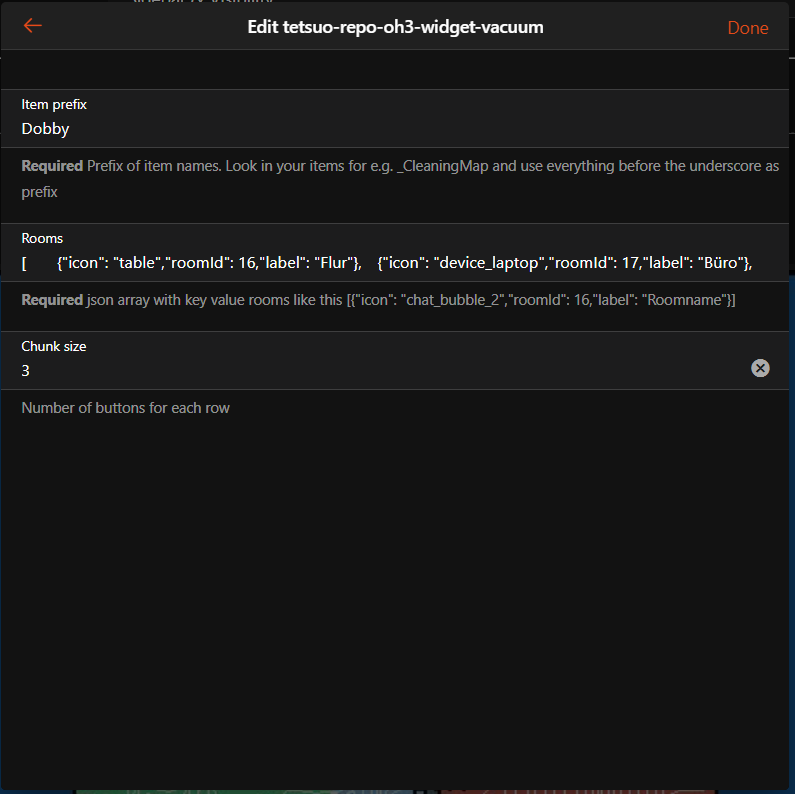

Oh, sure. If you add the widget to your page, you have the configuration where you also add the item prefix.
There you have to put it into the rooms field.

Hi Silvan,
not sure if I’m able to help, but try these two hints:
  • Room numbers in JSON, have you tried if the room numbers in the json match the configuration of your Roborock? I did that by writing a simple script with the app_segment_clean[16] command

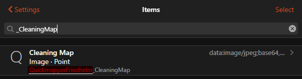

  • Item-prefix-configuration. As stated in the configuration hint, search in your items for (i.e.) _CleaningMap and use the prefix (everything before the underscore) in the configuration

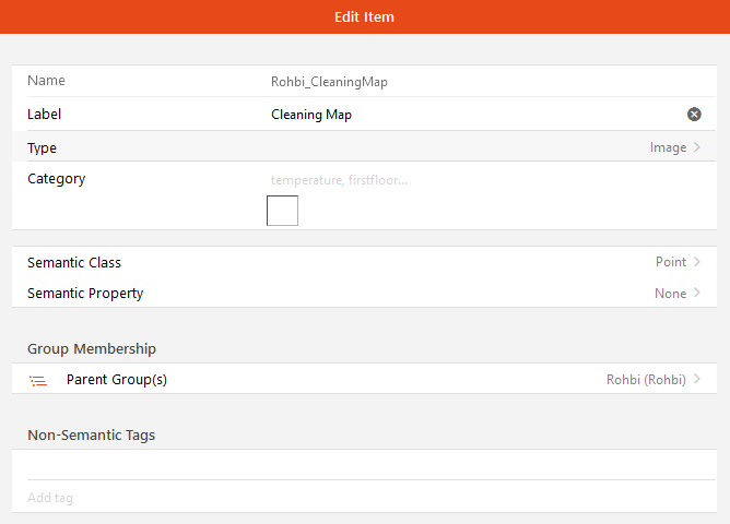

is your map item set to image type?
Thank you! It’s executing now.
The map item has been set to image type and the map is still not shown.
Hi @boozzz, is the image just not showing within the widget or is the map just not showing at all?
And have you configured cloud connectivity in the binding? That was my issue why it did not load the map.
@wzbfyb Cloud is enabled.

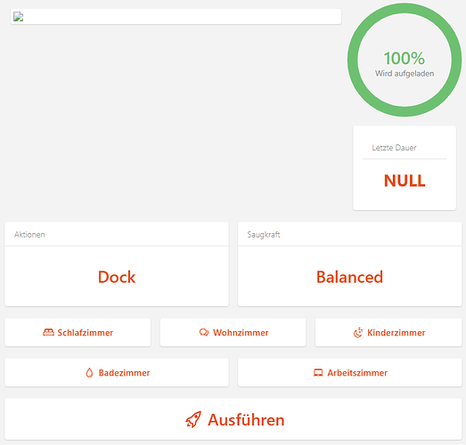

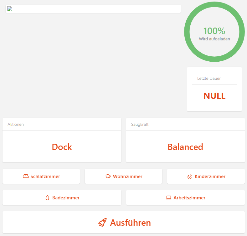

@Tetsuo The image is not showing at all. In the Things Channel it is also not showing.
