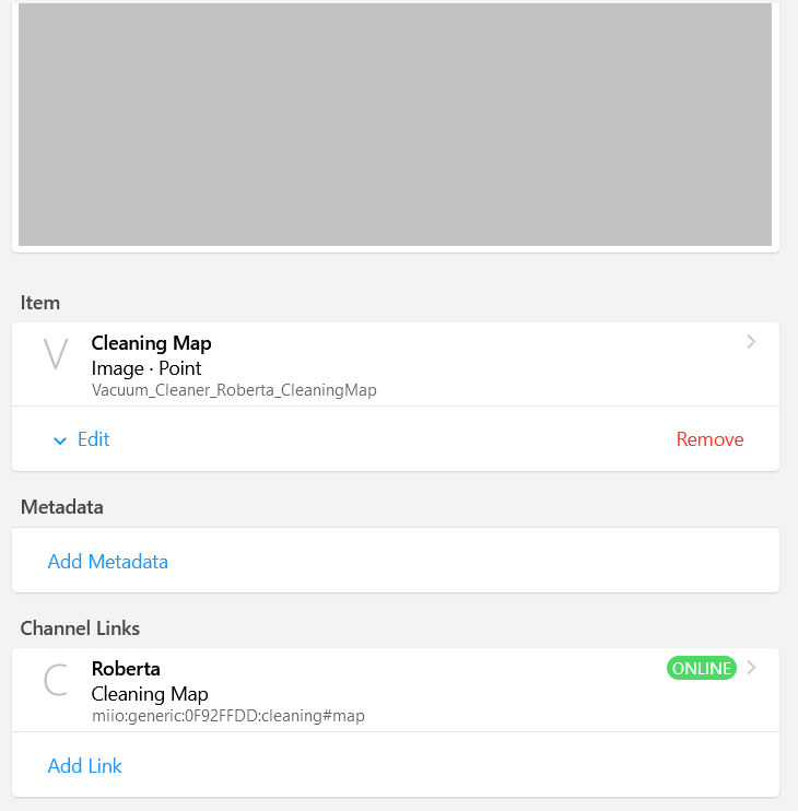

Hi, I’ve the same issue with getting displayed the cleaning map in OH3.1. The _celaningMap item is created as type of image and it’s value alway is NULL and no image is displayed.
grafik
No errors in the log file. In DEBUG mode the rrmap files were saved in /var/lib/openhab/miio and there were no problems with the communication to the cloud. All other data are displayed correctly in the items.
Did you get your map working, yet?
That would indeed be odd, I’m not aware of specific issues for the maps in 3.1.
Esp if you have rrmap files created and no errors.
Are you 100% sure it is linked to a channel?
If indeed that is the case, share a debug log.. maybe I can detect something odd that would be causing this. Another thought could be to download the offline map viewer, and see if that one shows something with the rrmap files
Yes, 100 % sure it is linked to a channel. The screen snipped shows the grey image and the channel which is the item linked to.
I also downloaded the offline map viewer and can see there my map loading a rrmap file which was created in DEBUG-Mode before.
It seems to me like the item not getting updated with the map image. All other items of the vaccum getting updated periodically.

Yes, indeed something is happening in the parser. So at least it gets to the processing stage as you have a line.
2021-11-24 15:15:56.109 [DEBUG] [inding.miio.internal.robot.RRMapDraw] - Identified rooms in map: 16 17 1 18 19 20 21
RRMapDraw is responsible for rendering the image. The only thing that comes to mind was an issue with the fonts, which was reported long time ago. (somehow java did not see any available fonts in a headless server).
To avoid the text, checkout this post Xiaomi Robot Vacuum Binding - #1895 by marcel_verpaalen mapConfig.json should contain an empty text like this { "text": ""}
You can also try the following { "text": "" , "cropBorder": -1 , "showLogo": false} as that avoids some nastry logic.
Note, your path of the file is somewhat unusual (it does not contain the usual userdata part), I think the mapConfig.json needs to be stored in the same folder
Unfortunately no changes in behaviour.
I tried to use { "text": ""} or { "text": "" , "cropBorder": -1 , "showLogo": false} or a blank file named mapConfig.json in the hope the binding will create a valid file out of it, only for testing, if this file is recognized from the binding. But the file leaves empty.
After editing the file mapConfig.json I restarted first the binding, than the openhab service and than editing some minor changes to the thing. Nothing changed in concern to the mapConfig.json file or the display issue of the map image.
I put the file mapConfig.json to this location /var/lib/openhab/miio. Here also the rrmap files and miio-Tokens.json files stored.
The log shows the same as before an ends with:
2021-11-24 18:26:36.226 [DEBUG] [inding.miio.internal.robot.RRMapDraw] - Identified rooms in map: 16 17 1 18 19 20 21
I use openhabianpi installtion of OH3.1 on an raspberry pi 3b.
Did you expect any more log messages after the last one with RRMapDraw? I see no java errors or other errors in the log concerning this issue. Maybe some general issue with image item in OH3.1?
I did not use the image item before, so don’t know if it is working in general.
Ah.. yes, this mapoptions were only introduced with the 3.2 version indeed.
No, there are no log messages expected in RRMapDraw. I would indeed expect a big ugly unhandled error stacktrace in case of an error.
Only thing I can try is to compile a version with some more logging to dig deeper.. but maybe try to load the 3.2 version first (I think you can use 3.2 bindings jars in oh3.1)
