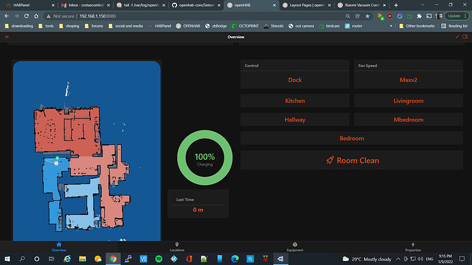

hello,thnx for this super widget.I have a weird small problem with room cleaning,if the room number is 1 then it sends
Item 'MiRobotVacuumV2_Actions_ExecuteCommand' received command app_segment_clean[]
and not
Item 'MiRobotVacuumV2_Actions_ExecuteCommand' received command app_segment_clean[1]
as it should be.Any ideas?All the other numbers from 2 and up are working fine.
Hi @Constantinos_Contis,
think you’re using a modified version based on my post where I tried to help you.
I can only guess and hint you to have a look at the line in the widget, maybe there’s some check of yours wrong:
Or maybe post that line and I can see if I can help you!
got it …thnx.At 50 years old my eyes and my brain arent work together well :slight_smile:
