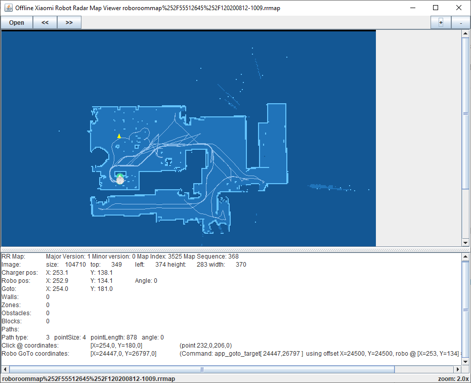

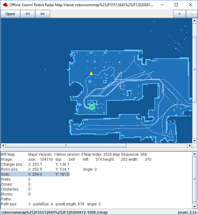

I toyed a bit with moving the vacuum (command: app_goto_target[x,y]) which gives the exact coordinate of the goto pos in the viewer, hence helps finding the formula.
Seems for me the calculation from viewer coordinate to goto coordinate: ( offset + Click Coordinate) * 50
X offset= left+width, Y offset = top
I included the calculation in the viewer for easy usage

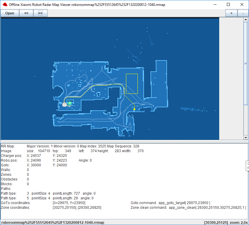

Fixed the calulation to be universal. You can find the download link in the first post.
What’s new in this version:
  • Shows coordinates according the vacuum instead of # of pixels
  • Mouse-over gives coordinates in status bar
  • Mouse wheel will zoom in/out
  • Can give filename in the command line o start with specific file
  • Clicking in the map gives goto command
  • Click & drag will draw rectange and provides the zone clean command to use
  • Images and lib are in zip for easy execution

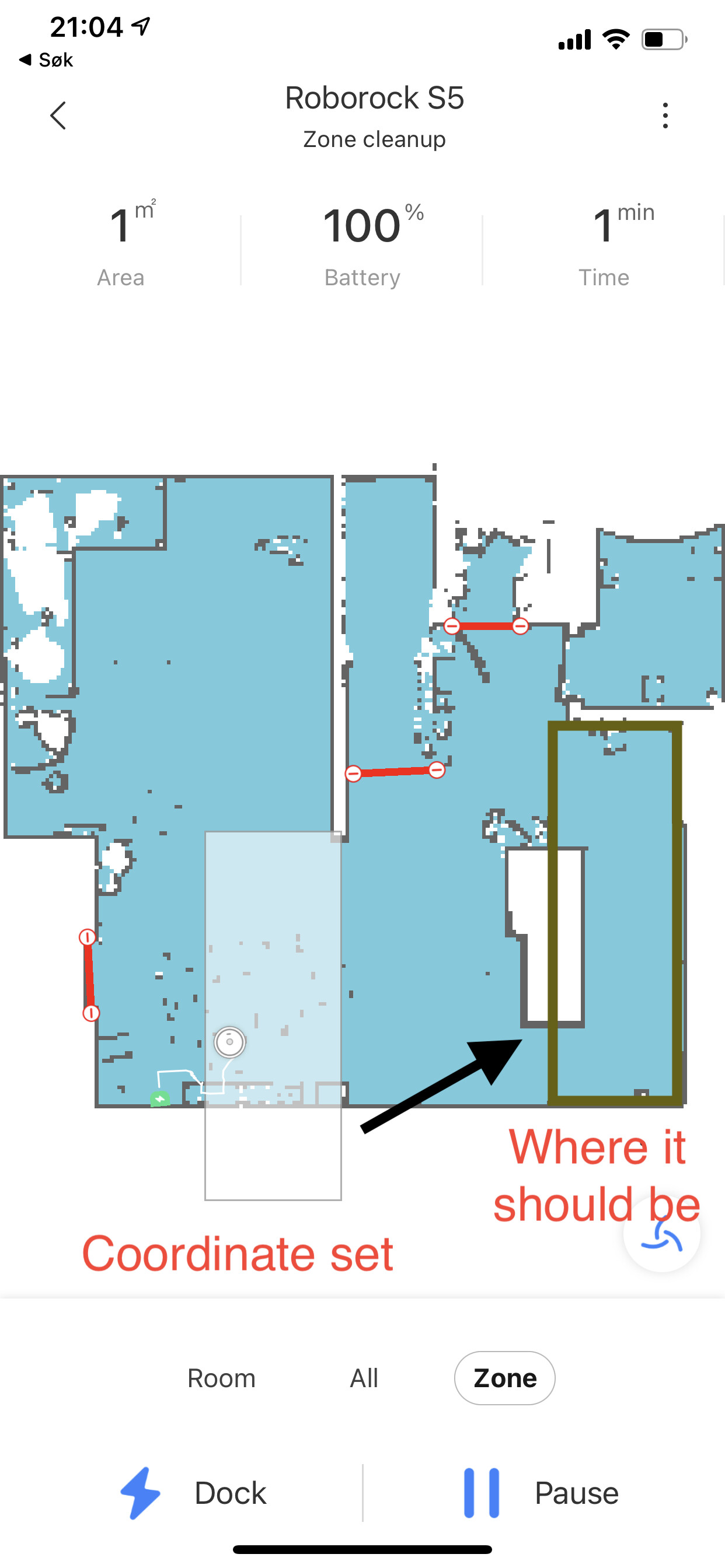

I can find the map and also open it. The zone is marked and the coordinates are also displayed in the app.
When I start the zone command (“app_zoned_clean[28150,28000,2970029100,1]”) the vacuum cleaner (S6) also starts immediately and reports zone cleaning. So far everything is fine!
Unfortunately the coordinates seem to be wrong. The whole ground floor is cleaned.
Where could the error be? (Openhab 2.5.8-1)
You are missing a comma.
