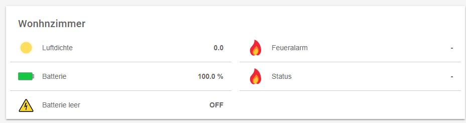

But i can’t read the values. only battery value is 100%

After restarting everything works fine. - but smoke sensor still have no output.

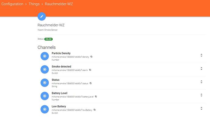

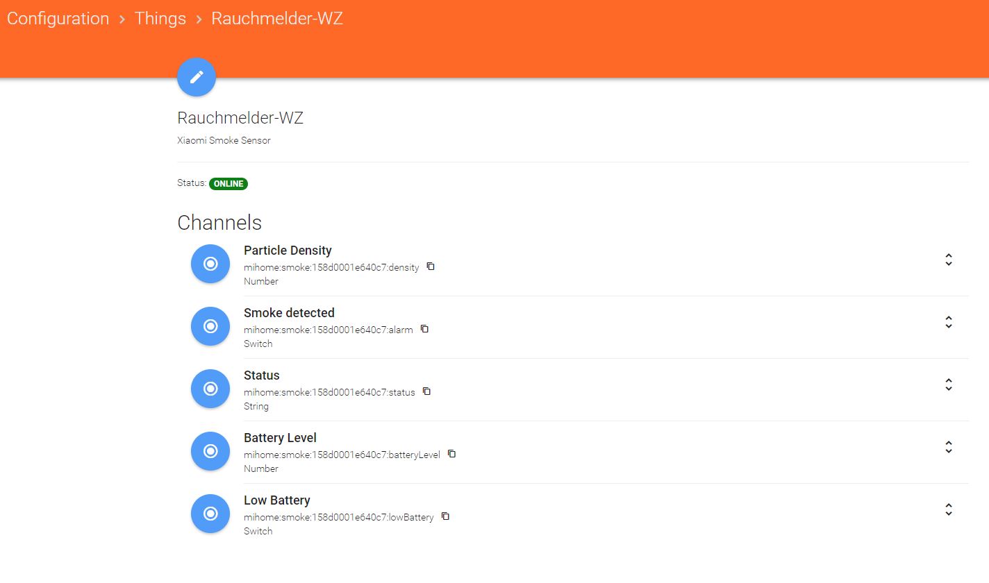

Here are the Screenshot with of the thing:
It still not working.

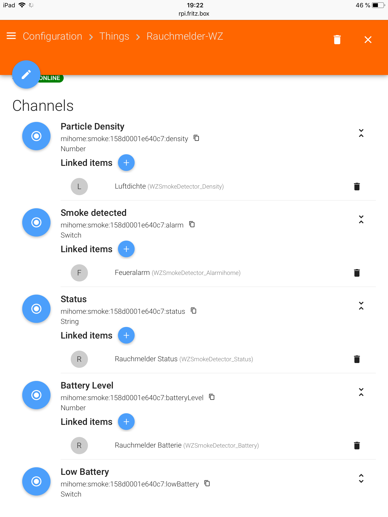

I think, you don’t need this definition for 2.3., because you use things and channels in PaperUI, so I would check, if it works without.
PaperUi didn‘t show the Smoke Detector Items in Control-Board, it only shows in BasicUi. I will make some smoke tests to get more results of smoke detectors.
