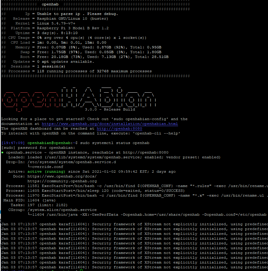

I am using OH3 RC2 and am getting “Security framework of XStream not explicitly initialized, using predefined black list on your own risk.” in the log when starting OH. This appears to be new to RC2. Does this indicate a problem or is it something that can be ignored?

For what it is worth, I just pulled the latest Docker image 2 days ago, and I am getting this message now. The only add-on I have installed so far is zigbee. I did have a couple false starts on setting it up, so it might not be a 100% clean install.
I just noticed it, but I after I was able to create a user and start adding things, I was too excited to check the logs right away.
my best guess is that somehow something outside of docker changes, or a setting gets triggered in the docker instance to do with the hardware interface. But I know very little about how it all works
