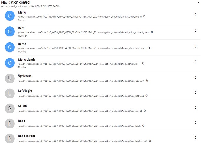

I am also interested in a description on how to use the navigation controls in order to choose a net radio station. I am actually struggling to understand how to bind the channels to an individual item as these navigation channels do not provide any item type, such as string, number, switch, etc.
I would expect to use the navigation channels within a rule, but what’s the path to walk from here?
The problem is the lack of matching widgets. The channels do have item types, but there is no pushbutton, no up/down button only a switch so far. Therefore paperui cannot provide means to control those channels.
