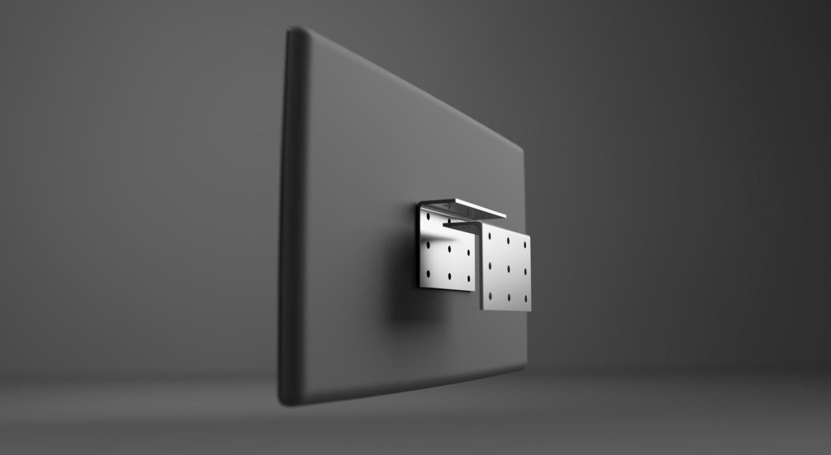

That’s how I attached my Tablet to the wall…
Used heavy duty Tesa “power strips” to attach one bracket to the tab.
Second bracket is screwed to the wall.
Advantage is you don’t see the fixture and the Tab “floats” infront of the wall.
Two Bolts into the top holes connect the two brackets.
