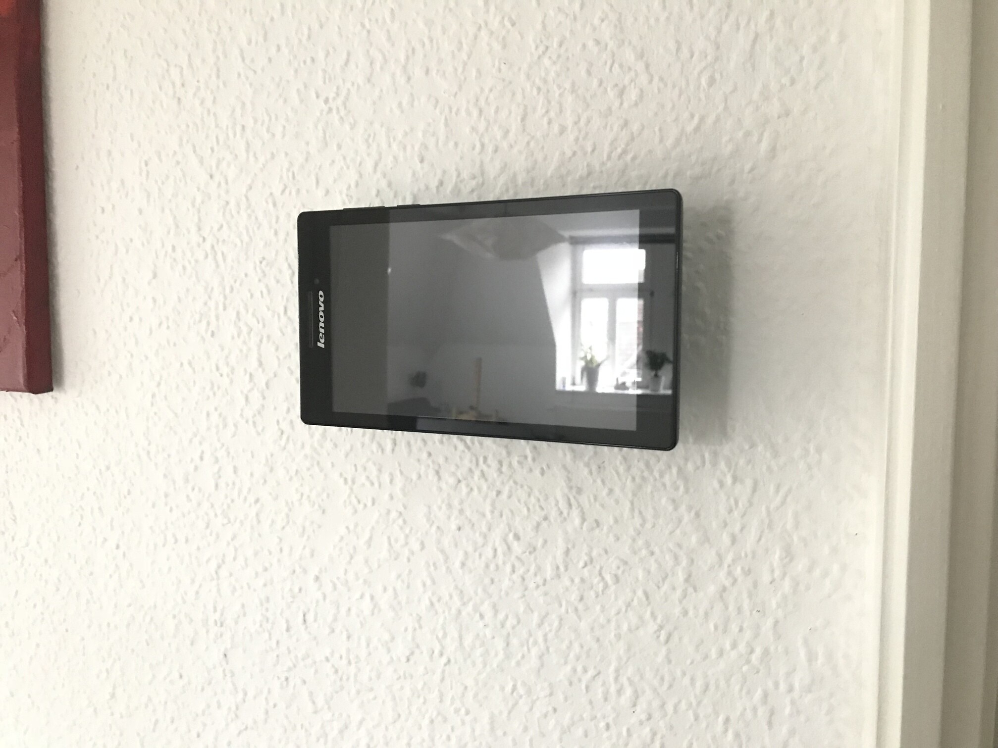

So now I installed a PoE to USB converter in a small space I had to carve in the wall behind the tablet.
When the tablet is fully charged there is basically no noticeable heat on it or the converter even if the screen is always on.
Converter can become hot only when charging a significantly drained battery, which eventually will happen in case of a prolonged power outage.

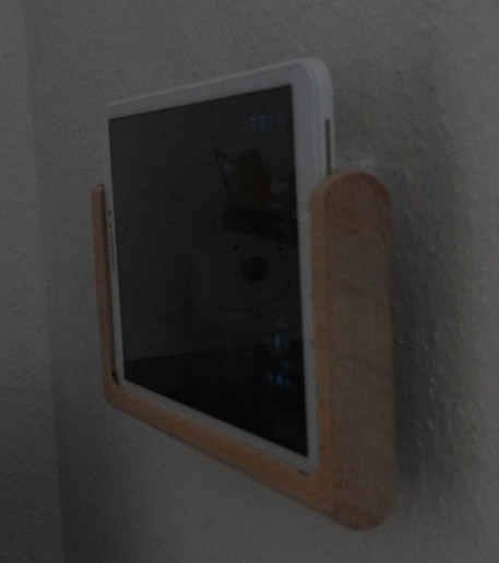

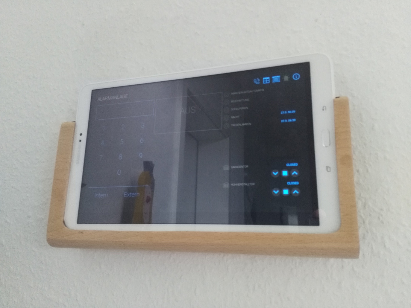

I had a piece of wood lying around and used that to create a mount:
It only took 2 hours to make it and it does not look too bad. It is mounted pretty close to the wall and covers
a usb power socket that powers the tablet. You can see a part of it glimpse out behind the tablet:
It is an android tablet running habpanelviewer, which is an app I wrote myself. You can find it here on the forum.

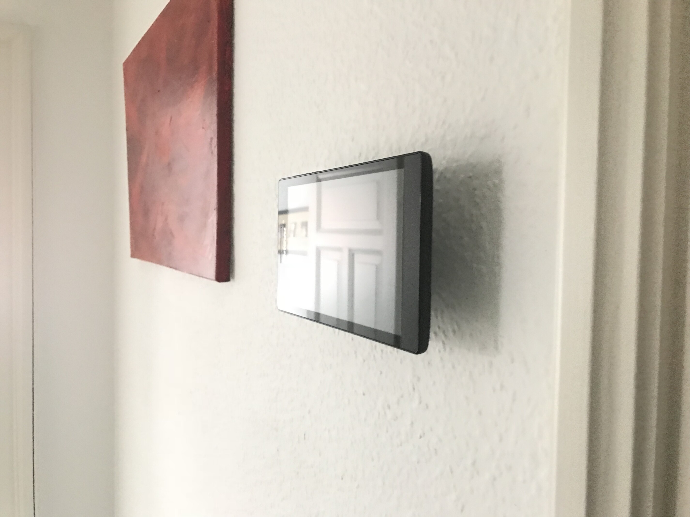

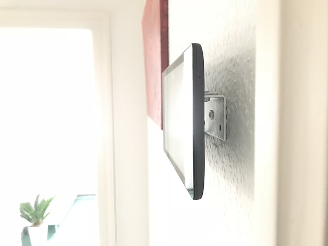

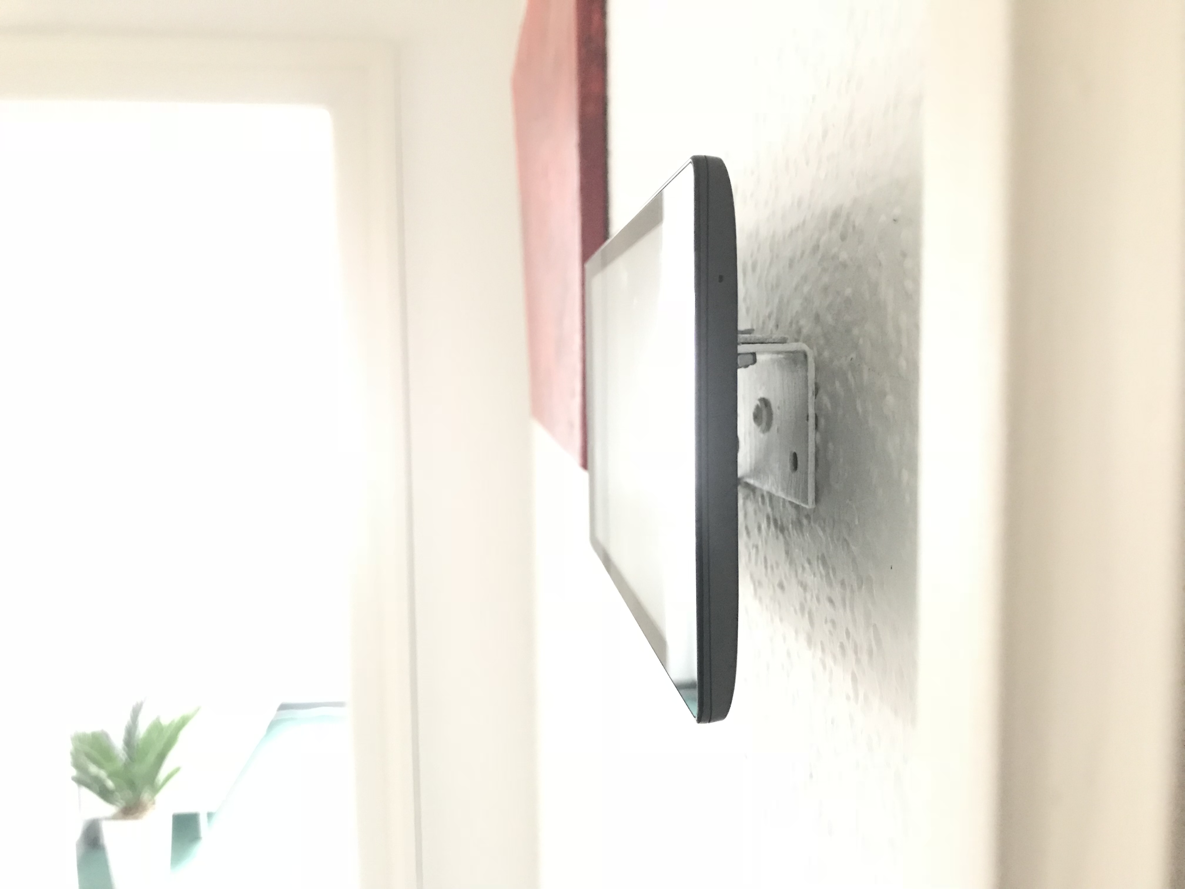

That’s how I attached my Tablet to the wall…
Used heavy duty Tesa “power strips” to attach one bracket to the tab.
Second bracket is screwed to the wall.
Advantage is you don’t see the fixture and the Tab “floats” infront of the wall.
Two Bolts into the top holes connect the two brackets.

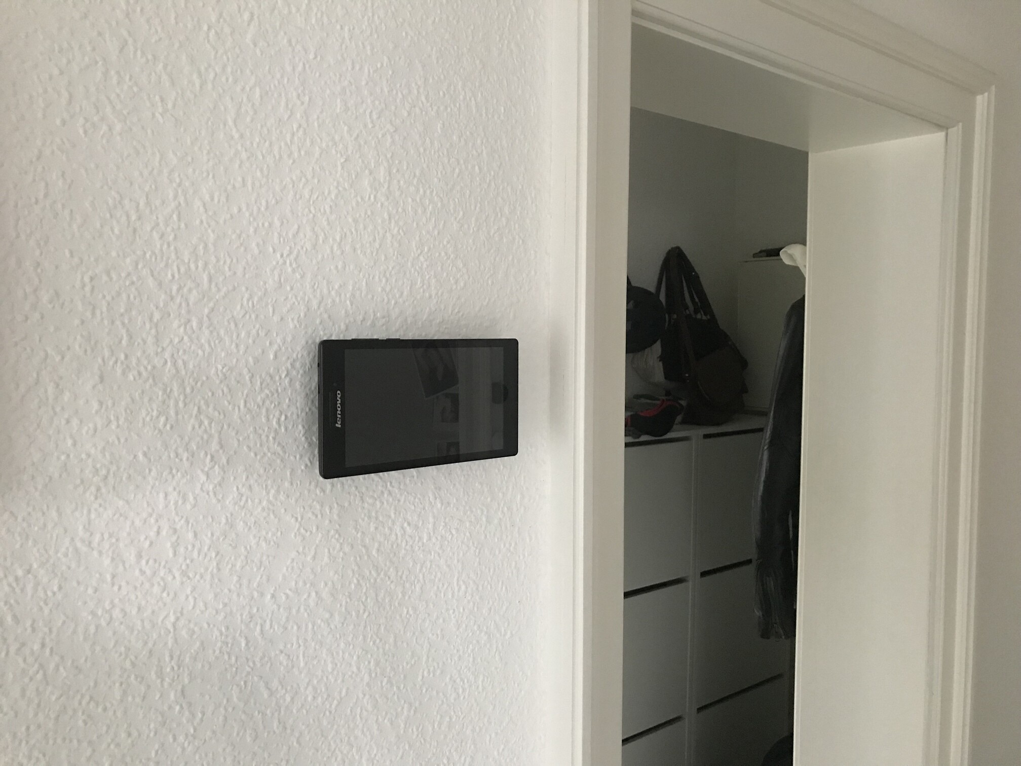

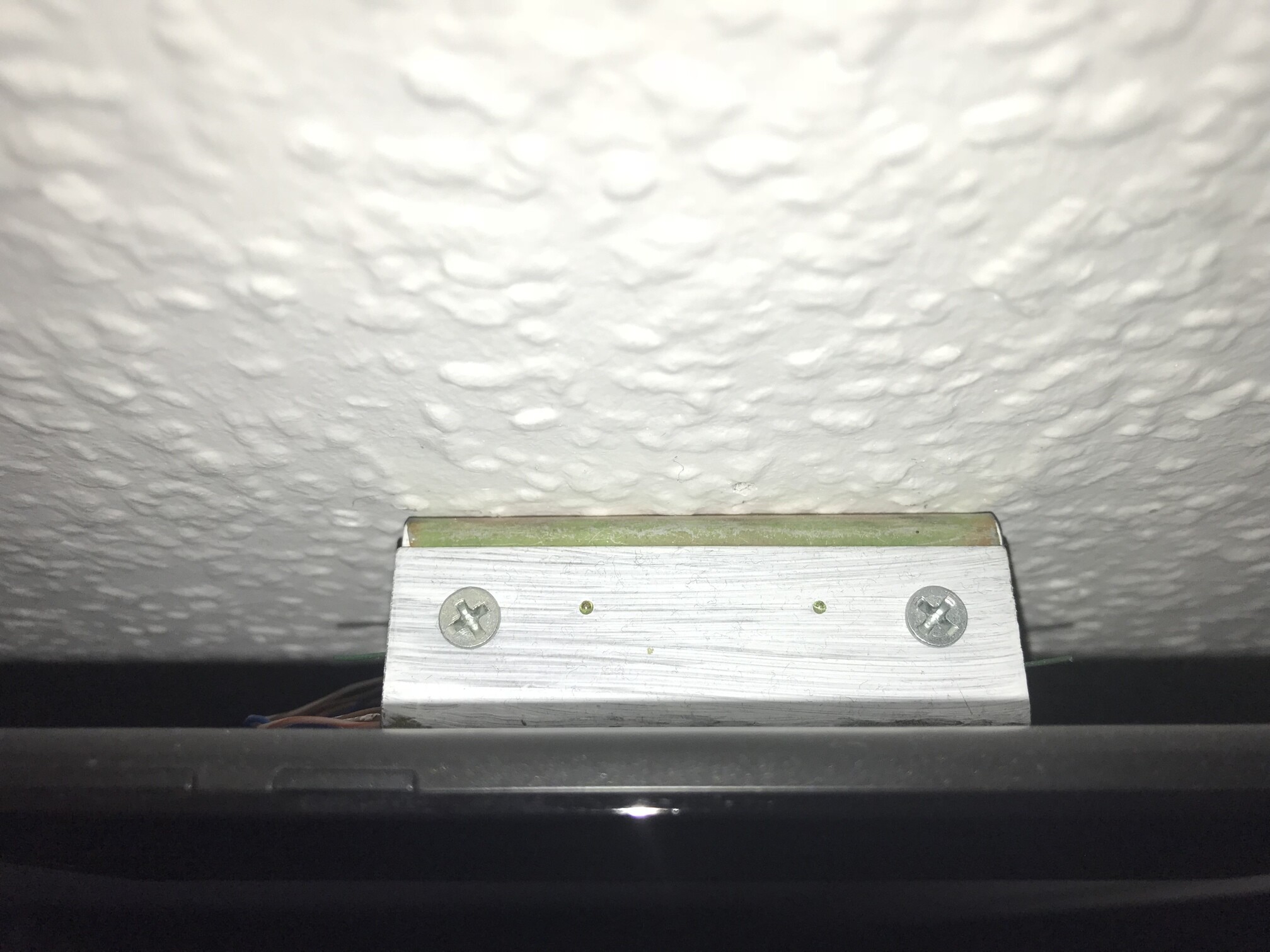

Can you show us a real picture of your mount?
Have you screwed the two plates together or are this two bolts only put into the holes without any further mounting?
I’ll take a picture when I get back home.
It’s bolts with nuts, so that the connection is rigid with no flex.
That is exactly how I did it:

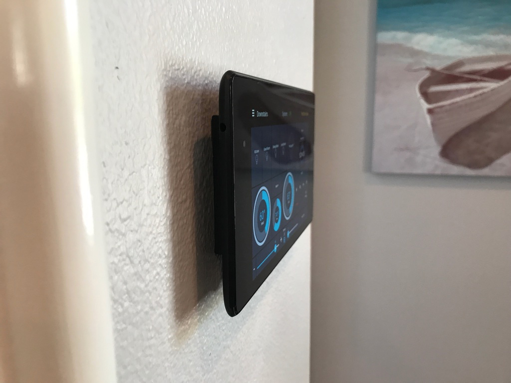

I have an old Nexus 7 with a dock. I was initially going to use Ubuntu to run it in some sort of kiosk mode, but it was clunky. I rolled it back to Android 5.0.3 and found Fully Kiosk Browser. Now it works great! The dock not only helps it pass the wife’s aesthetics test, but gives it portability when I want it! (Please ignore the licensing watermarks. I took this photo when I was first testing the app.)
Here are some Pics:

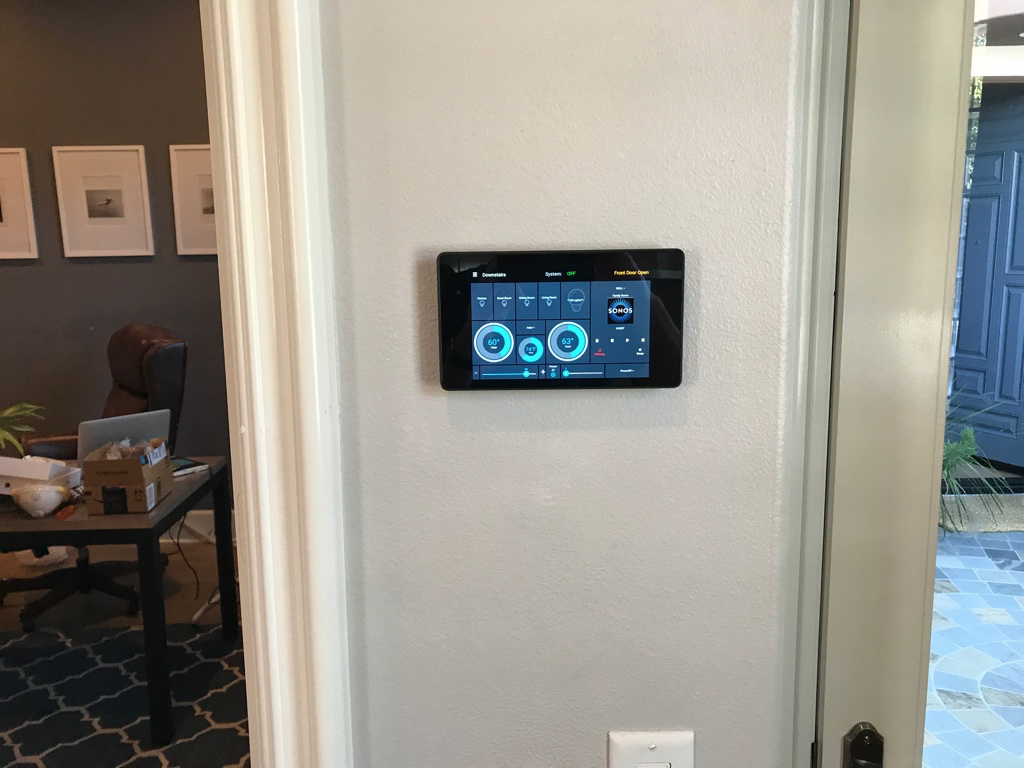

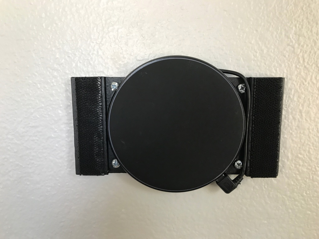

So I replaced all of my 1st gen Nexus tablets + asus dock (what @William_Hedrick has above) with 2nd gen Nexus tablets. The big benefit was a much faster processor (and 2gb of memory!) plus wireless QI charging. I can pick them up on ebay for around $75. I have a wall mount setup and a counter setup. My wife is a residential and commercial interior designer, so aesthetics are important :slight_smile:
This is my homemade wall mount, it uses a wireless QI charger, some hobby wood painted black and 3m picture Strips. The stips are rated to something like 20 pounds, so they really hold the tablet, but allow for easy removal if I need to work on the tablet.

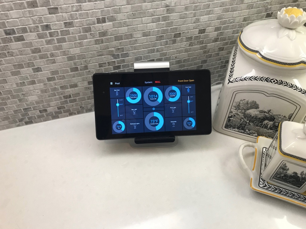

The counter top version uses just a simple QI wireless stand, The picture does not really do it justice, but this stand makes the tablet feels like it’s floating on the counter top. This obviously makes it easy to pick up the tablet if need be, but most of the time I just used it mounted. I was afraid it might be flimsy just resting on the stand, but it’s very solid.
