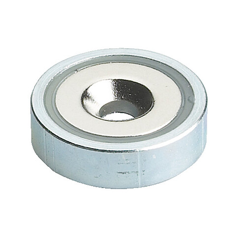

I’m using two of the following type which alledgedly can carry 0.9 kg each. I have superglued the thin plates to the tablet and and used a screw the in the center for each wall mounted magnet. I have to slide it off because pulling feels like the screw is gonna come out of the wall, those are strooong.
Edit: Actually they might even be 7kg each, I think I looked at the wrong specification.

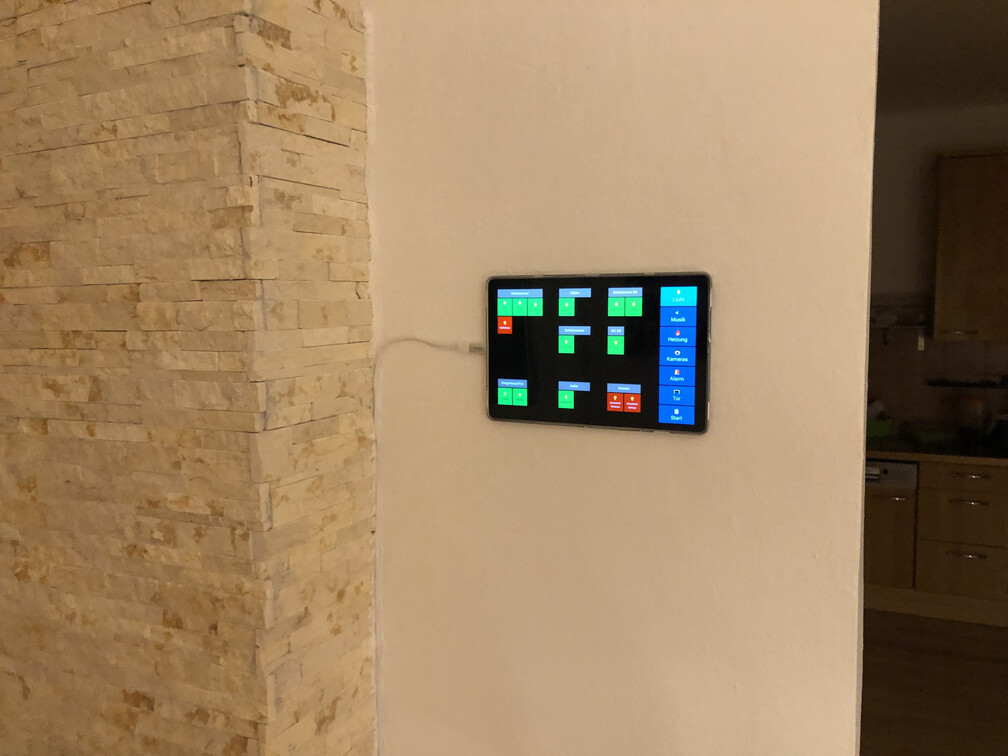

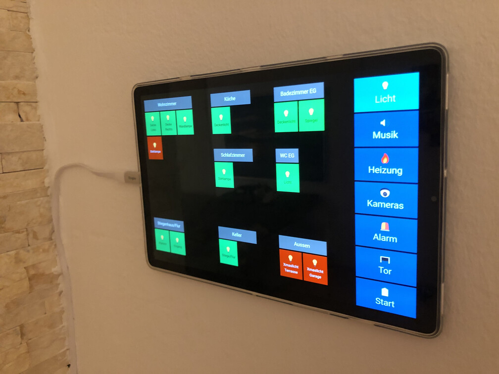

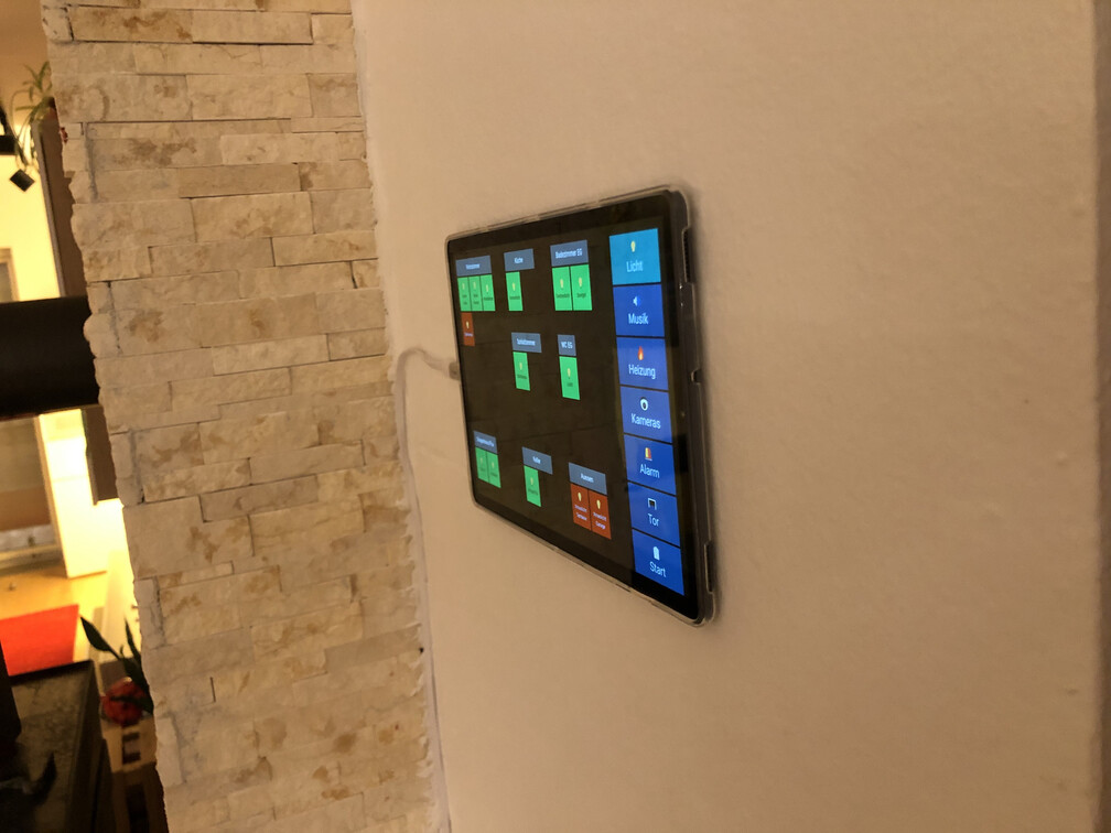

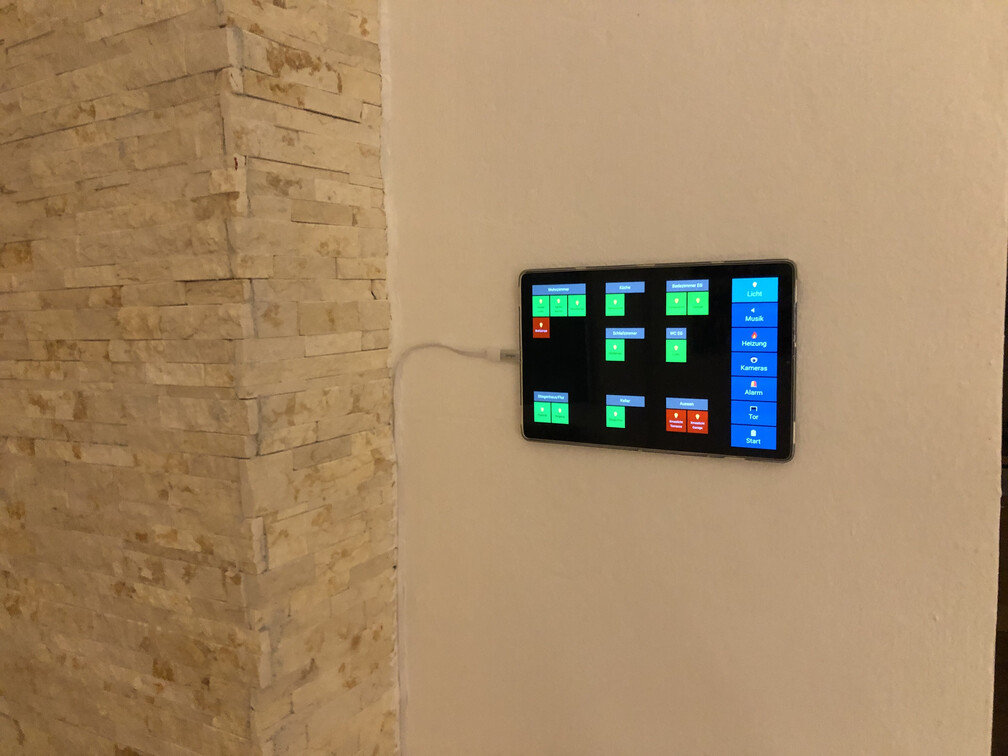

One of three Habpanels. Samsung Tablet, mounted with a standard silk-case.
Hi, please can you tell me, how you get such small blue widgets with the room description in it?
When i make some dummy widgets or label widgets, the minimum hight is like the big icons on your right side. But your description widgets only have half of the hight.
You can setup it in the dashboard settings. Choose “Row-height” 50%, and so you get smaller lines…
Thanks! That works, i like the design of your tablets with the panels - black an coloured widgets with strong different colours.

What’s behind the wall? Could you drill through it and hide the charger behind it? You get rid of the cable that way.
If dry-wall, could you pop a hole this side and drop a cable to the floor and fish it out there?
