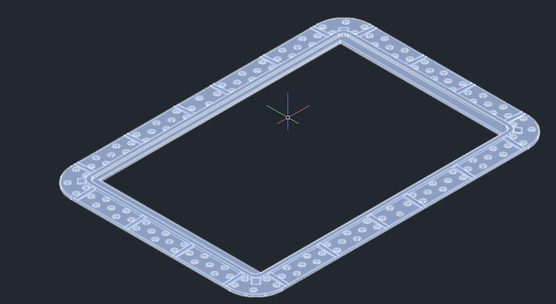

How did you build it in the wall? You don’t have any pictures of that by any change? I 3D-printed the mouting brackets, but didn’t found the time (and motivation) to build it in the wall…
Beside, what are you using as output on your screen? HABpanel, or the new UI? I’m in a review of the current setup, so I’m open for suggestions. :wink:
Sorry no pics during construction - this thing took me about 40-50 hours :laughing:
Used:
Had to cut the cover a couple of times so the screen fits in - but was afraid I could cut too much so it can’t fit the 3d print mount. I think I screwed it onto it.
I can uplaod the *.dwg and *.stl file if you want.
I did the holes so the plaster would fit better.
