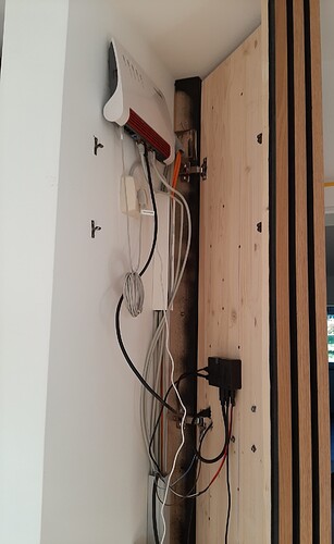

Behind the wall:
Setup:
acustic panels: Fibrotech - Fibrotech
Client: Odroid C4 running Andorid Pie with Openhab App.
Display: Waveshare 10.1
Seems like we have found the definition of great minds think alike :wink:
I had to deploy some special tactics to make it work though. Had to run 2 flat usb-c cables as well as the thinnest flat HDMI cable I’ve ever seen behind the wood panel and then up into a cupboard as there is a thin wall and then the refrigerator on the other side…
